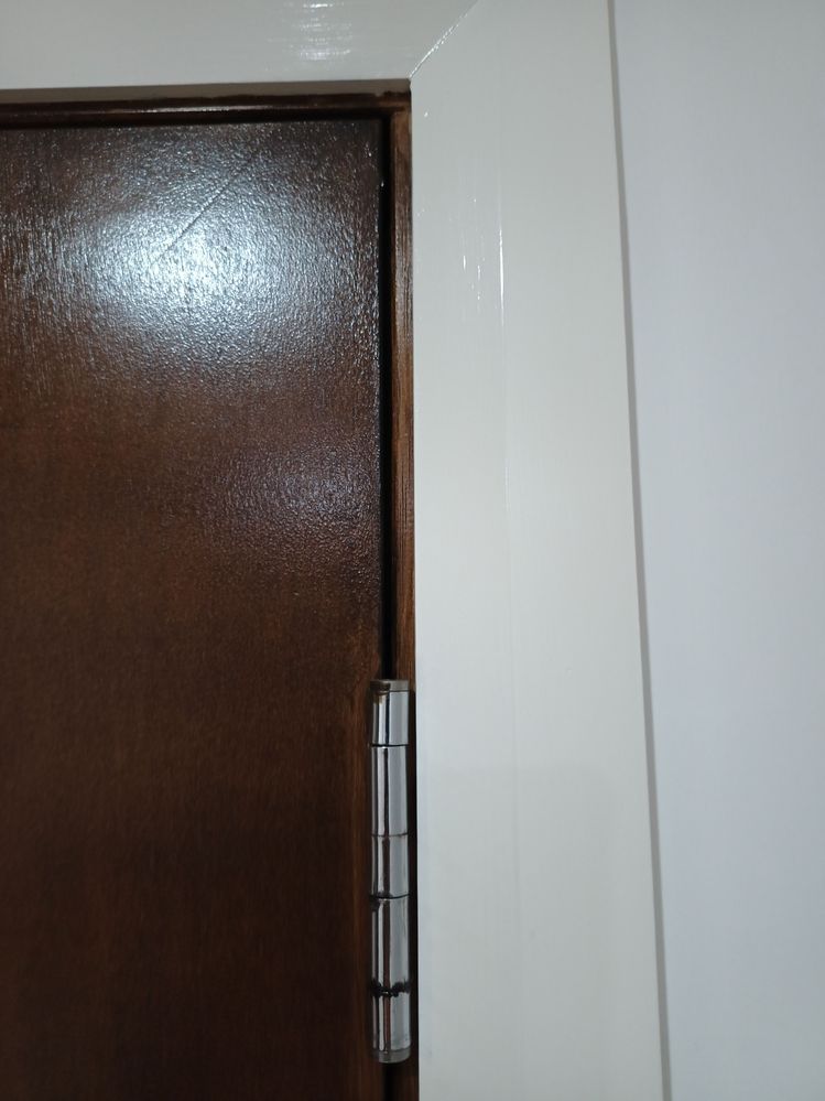

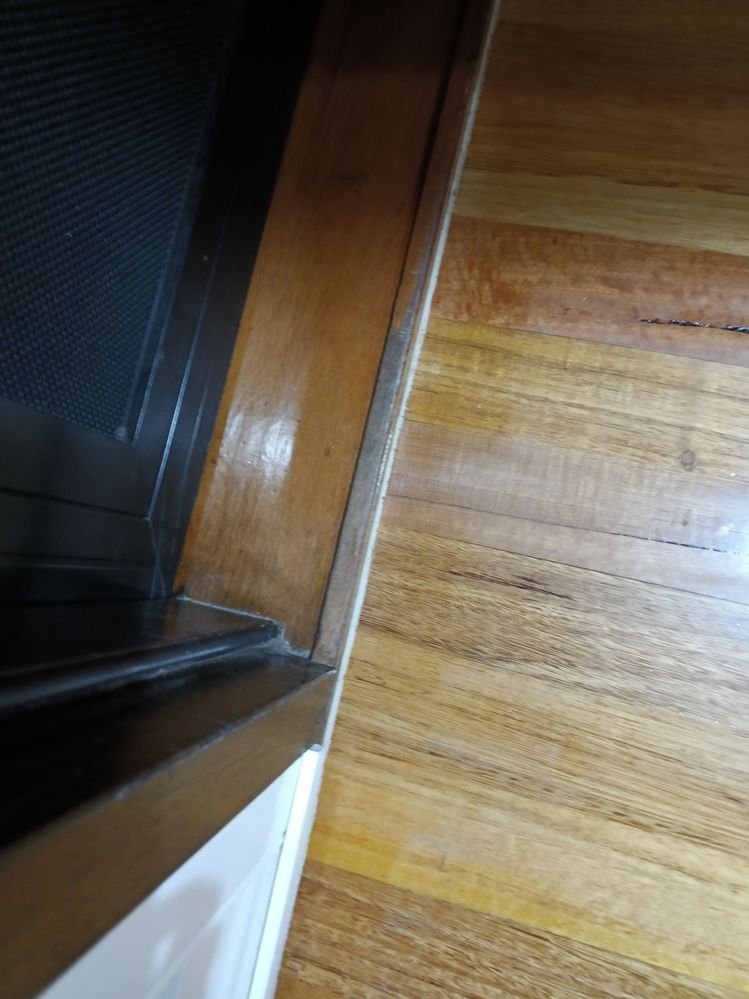

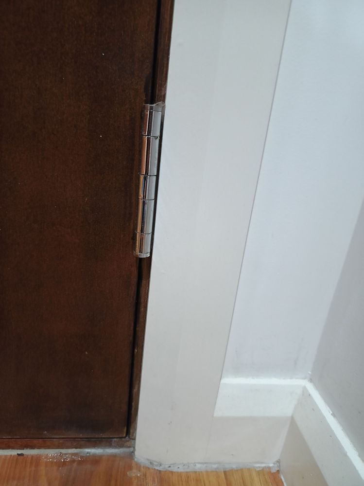

Thanks Alan and Jacob. I have attached some images. The door is sticking at the bottom. Also the bottom hinge has less spacing on the side compared to the top hinge. Since this is the front door, will a cardboard shim be suitable. Are there any links for a suitable front door bootom framefront door bootom frameBottom hingeBottom hingeTop hingeTop hingeproduct?

Thank you very much for sharing those photos of your door. It's possible that the rebate made in the door is too deep and is pulling the door very close to the door frame. I agree with @JacobZ's recommendation and that is to either sand it down or to plane it so that there will be enough space between the door and the frame. Please make sure to repaint the surface of the exposed door so that it will not get moisture damaged.

Weather conditions cause the materials in the door (especially wood) to expand/contract which is the cause of your door sticking at the bottom of the frame, I note that the gap is larger at the top of the frame than the bottom, had it been hung a few millimetres higher on installation that door (in it's current form) would not be sticking, you can of course re-hang the door slightly higher but planing off a few milimetres from the base is far less labour intensive, note that when warmer weather returns the gap will increase slightly as the door contracts, so go easy on the planing 😉

I'm not sure I understand which edge you believe is sticking, Is it the actual bottom of the door or the lower edge where it can rub on the door frame upright?
If it is the bottom edge then shimming the hinge may work but it may then cause it to catch on the side upright of the frame. I have in the past , where it is the bottom of the door, found that simply putting a piece of sandpaper down on the floor and opening and closing the door repeatedly till it shaves down the door to stop the sticking. The same can work for the side edge but you will need to take more off to allow for repainting the exposed edges.
