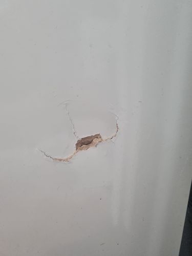

Hi all,
One of our doors has a hole like this:
What do you recommend is the best way to fix this?
Thanks
Community manager's note: Check out How to repair a hole in an internal door for expert advice.
Welcome to the Bunnings Workshop community @diy_dude. It's sensational to have you join us, and many thanks for your question about repairing a door.You might like to have a read of this discussion: How to fill holes and gouge in my door by @vica. Our helpful members offer some excellent advice to @newfast on repairing their damaged door. Though their damage is more extensive than yours, and it appears you'd get away with just filling the area.
How solid is the damaged area? You could either try to fill over the area with Builder's Bog or remove the broken sections of door skin and fill over the internal cardboard honeycomb. I prefer to dig out the fractured sections of door skin and then fill the area. The reason for removing the door skin pieces is that it will then give you some defined edges to bog up to and then sand back flush with.
Once you've filled the area with bog and then sanded it back so it is flush with the surrounding surface, you'll need to prime and paint the door. You'll achieve a far better result if you paint the whole door instead of trying to paint the patched area. Remember your PPE when using the bog and sanding, including gloves, a face mask and safety glasses.
If you haven't used bog before or are not confident in the repair, given the price of a new door (likely close to the cost of the materials to repair this one), you might like to consider replacing the door. You'll see the internal doors are quite budget-friendly.
Thanks @MitchellMc yes, I was thinking of replacing it with a new door, but it is kind of hard to find a door with the exact size.
Hello @diy_dude
If you wish to order a custom sized door, I suggest measuring your current doors length, width and height. I then recommend going to your store and proceeding to the special orders desk. Show the special orders team the size of your door and ask them for a quote. Once they process the quote for you, all you need to do is to decide if you wish to proceed with the order.
