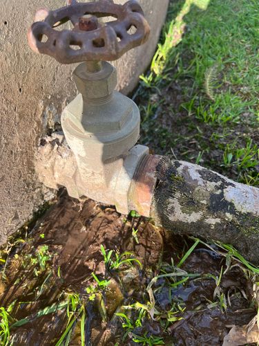

Any ideas on how to fix a leaking tap on a concrete water tank? Leaking a continual drip from underneath
Hello @max77
Welcome to the Bunnings Workshop community. It's wonderful to have you join us, and thank you for sharing your question about repairing a leak in your concrete tank.
If the leak is near the tank close to the shut off valve, I suggest locating it first and cleaning the area with a bristle brush. Wash the area very well making sure that the moss, mould and debris are removed. If you need space to do the repairs, I propose digging some of the soil out so that you have space. I recommend using Gripset Betta 1kg Water Plug. This product is specifically designed to repair damaged concrete water tanks.
However, if the leak is by the hose area, I suggest removing the hose and refreshing the connection and using a Toledo 14-27mm Perforated Clamp Hose Fit to secure the hose properly.
