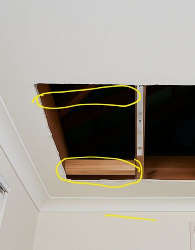

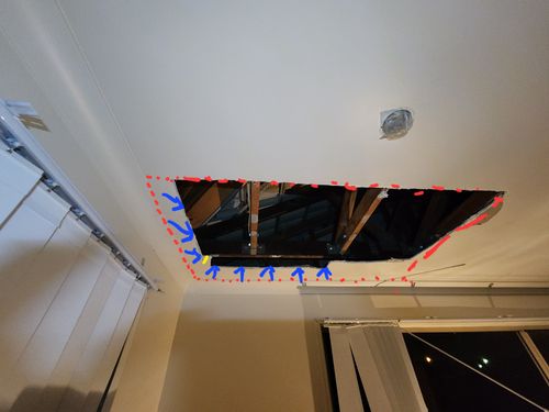

The house was built in 2000. I tried cutting out some of the sagged section, but the area near the cornice (marked by the blue arrow) is still sagging. I also tried pushing that section up to the joist (yellow point) to see how it would look with a new screw, but it still continued to sag.
Our question is: can we just cut along the red line and install a new board, leaving the cornice intact? It seems more straightforward and time-saving 😂🫠

Hello @ivanptr
I recommend stopping for a moment and consider removing the cornice in order to remove the entire sheet. The type of repair you are doing now is taking a lot of time with trial and error. Plus, you will not get a proper flat finish. By installing a new panel, you can be sure that the ceiling will be flat, and you will not have to do a lot of plastering. I suggest using a multi tool to remove and cut the cornice.

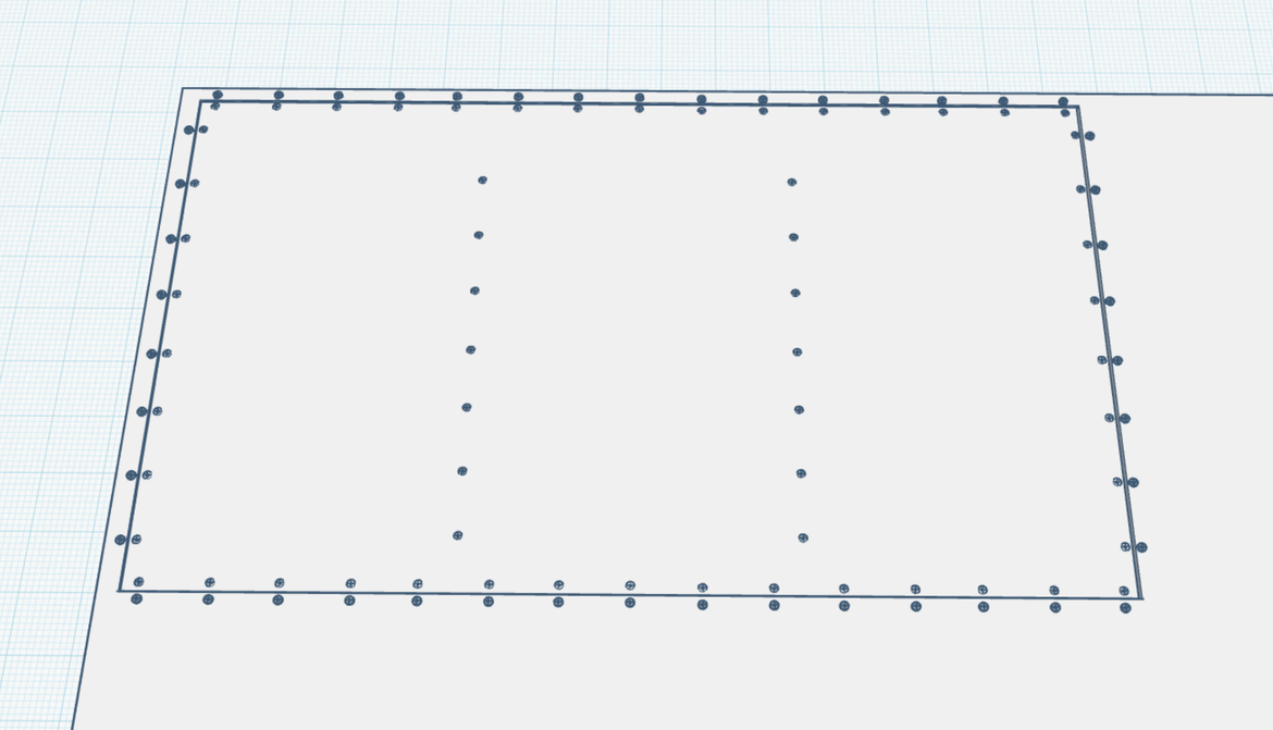

You should cut back to the middle of the surrounding timbers and screw them off to the timbers every 15cm around the opening. You can then cut your replacement section of plaster to match the whole size. You then be able to install it with Stud Adhesive and screw it off to the exposed sections of timber around the perimeter.
By cutting back the current plaster halfway through the timbers, you'll be able to attach both the old and new plasterboard to the timber as per my rendering below.
