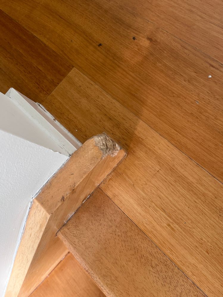

Can anyone suggest how to fix this? Moving around furniture it's been damaged on the wood at the top of the stairs
(see photo)

Welcome to the Bunnings Workshop community @KR1. It's marvellous to have you join us, and many thanks for your question about repairing a stair stringer.
I think the simplest approach here would be to cut off the top of the stair stringer and graft on a new piece of timber that's been planed to suit the profile at the top. You might not get an exact match on the timber, but it could end up looking like a bit of a feature. Cutting off the top of the stringer and either replacing it or trimming it down below the damaged section might give you the best result. From there, you could just fill and paint the wall. Since you’d need to be really precise, cutting so close to the wall—probably using a circular saw or handsaw—I’d suggest bringing in a carpenter or tradesperson to help out.
The only other option is to try filling the area with timber filler, though that’ll likely leave you with a patch that doesn’t match the colour and stands out quite a bit.

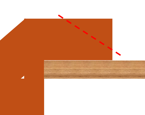

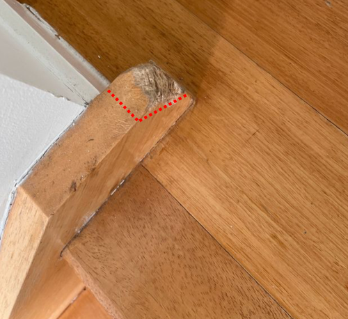

@MitchellMc has really touched on the two methods to rebuild the damaged section and if it was painted timber then either would work perfectly. But as its stained timber, as he pointed out, both repair types would be obvious.
So a 3rd possible solution would be to simply cut the damaged section off, sand and re-stain and make it look like it's supposed to be that shape. If need be, match the cut on the right stringer end.

I believe @Nailbag's suggestion is the easiest to accomplish, cutting the damaged section off and a bit of light sanding you can then easily paint the surface of the stringer. The added bonus is that it reduces its profile and makes it less of a tripping hazard.
