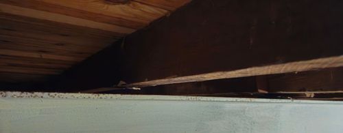

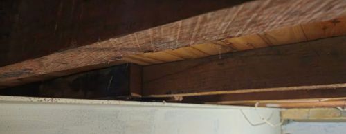

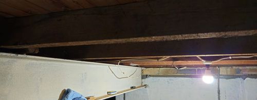

I’m looking for some advice about an issue with my floor. A bit of background: my house is a late-60s elevated single-story. The previous owner used packers to fill gaps between the steel beam and floor joists (some gaps are as large as 4-5 cm), which caused the floor to become uneven and vibrate when walked on.
I removed the packers, and the floor settled a bit, making it look better, but now I’m left with gaps as shown in the photos. A structural engineer recommended removing the packers completely and lifting the steel beam to properly support the floor. However, a builder I consulted suggested adding additional piers for support instead.
This has left me a bit confused about the best approach to take. I’m now considering reinstalling shims to eliminate any gaps larger than 1 meter between the steel beam and joists.
If anyone has dealt with a similar situation or has advice on the best way forward, I’d really appreciate your input!
