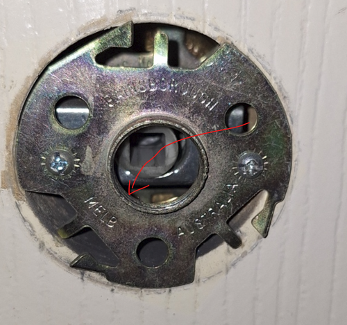

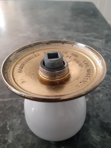

the Gainsborough door knobs are in good condition.
But on one side the inner thread on below  shows attachment seems faded away, so knob cannot be attached.
Since both door knobs are in good condition, can I buy only one side of below item or complete inner door part?
I could not find it in bunnings online.

Hello @ruwantha
In regards to your question, I believe Gainsborough does not sell half a door knob set. This is why you can't find it on the website. There is a dummy knob called the Ikonic White Heritage Door Knob With Brass Rosette, but is not compatible with the Gainsborough set as it meant for blank fixings only
