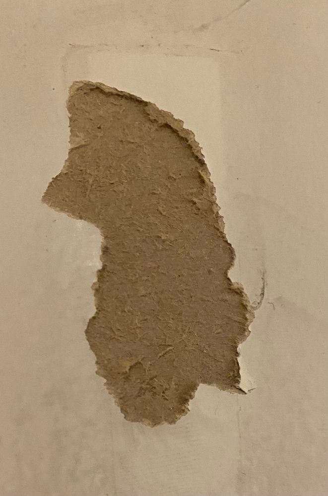

What sealer / primer to use for ripped paper in drywall? Is there a product similar to Zinsser Gardz Problem Surface Sealer?
Hi @Nanne,
Would you be able to post some images of the issue you are dealing with? That would greatly assist our members in offering some excellent advice. Are you trying to seal bare plaster, or has the top layer of the paper pulled away, leaving the bottom layer still attached to the plaster sheet? Are there any exposed paper edges? B.I.N Zinsser Primer Sealer Stain Killer will be fine for bare plaster or paper. The only thing is it's not quite as good at sealing lifted edges of the paper coating. Regardless, it's still likely our best sealer for your purpose. It is shellac-based, so you'll need to ventilate your house whilst it dries.
I'll be looking forward to hearing more about your project. Please let me know if you have any questions.
Hi Mitchell

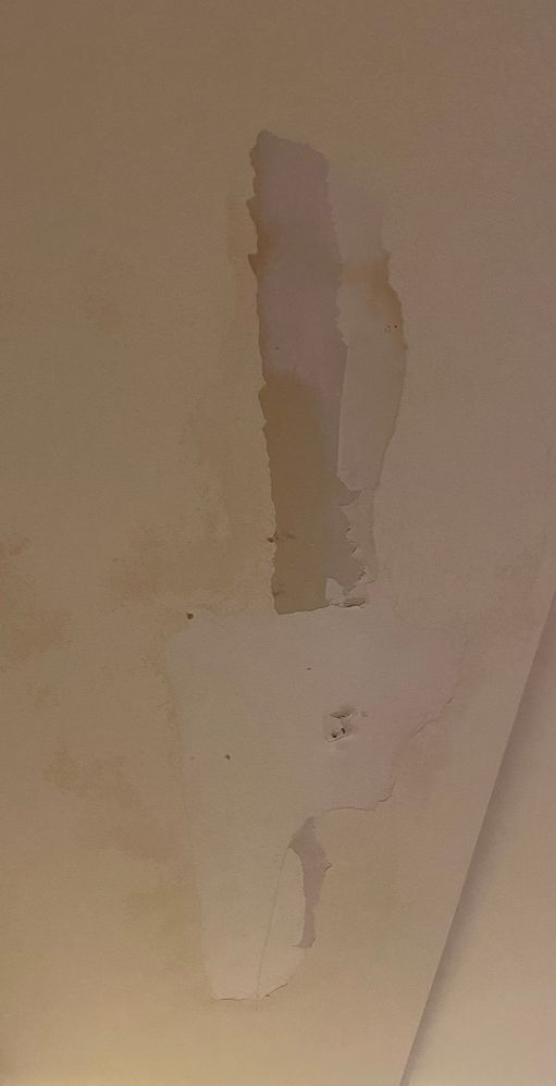

Water damage on the ceiling and ripped paper due to hooks.WallCeiling
Thanks for the images, @Nanne.
The damage in the first image needs to be filled with a skim coat of plaster and then sanded back flush with the wall. You can then use any standard sealer/primer/undercoat like Dulux 1 Step to prep the area for paint. In image two, you must take a scraper and chip away at all the loose material until you reach a solid area. You can then skim coat with plaster and sand the area before applying the Dulux 1 Step once again. Have a look at this step-by-step guide on How to repair a water-damaged ceiling.
If you were going to paint directly over this damage without filling, you'd need to use something like Zinsser Gardz to bind the edges of the paper. However, you'll need to fill these areas; otherwise, you'll see the damage through the undercoat and topcoat. This damage is typical of something that needs to be filled, sanded, undercoated and painted. Zinsser Gardz is usually used to bind powdery surfaces like degraded plaster or to seal paper coatings that are so old they are disintegrating.
