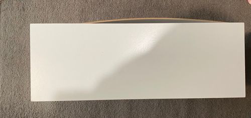

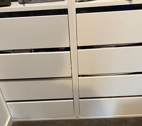

Hi, I’ve got multiple drawers with saggy bottoms and would like suggestions as to how to fix. There are about 8 drawers that were installed last year and are from the Kaboodle range so I would like to fix rather than replace.

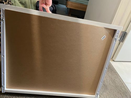

Thank you very much for posting pictures of your wardrobe drawers. I believe this drawer set is similar to the Flexi Storage White 3 Shelf 4 Drawer Built In Wardrobe Unit.
In order to reinforce the bottom panel of the drawer, I suggest putting in 3 rows of Porta 40 x 18mm 2.4m Moulding Pine DAR Clear cut to the size of the bottom drawer. I recommend applying Gorilla 236ml Wood Glue on the pine moulding and screwing it from the top side with Zenith 8G x 15mm Galvanised Button Head Stitching Timber Screws.
Place the screws on each side of the pine moulding as close to the sides as possible and one in the middle. This will prevent the panel from bowing and will keep it anchored to the side of the cabinet.
