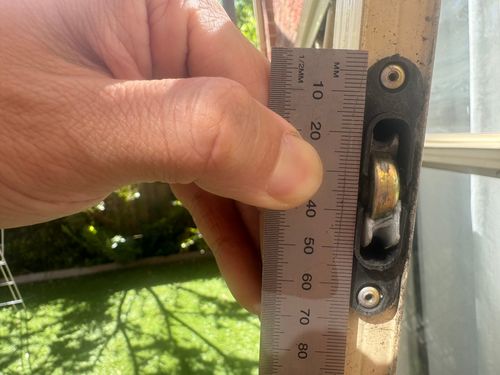

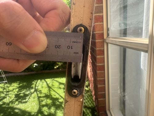

Could I get some advice on how to fix the roller of screen door please?
the wheels are broken but the set seems are ok, and they are attached using rivet nut.
i am wondering if I can just replace the wheels? I found some videos online but they are mostly around replacing the whole set.
thanks in advance
Welcome to the Bunnings Workshop community @aq. It's wonderful to have you join us, and many thanks for your question about replacing rollers.
Provided you can pull the roller wheel out so we can match it up with one in-store then replacing just the roller is possible. I suggest taking it into a store so a team member can match it up with one in a packet. It will likely resemble the Cowdroy 36mm Sliding Track Door Wheel.
You might need to use a pair of needle-nosed pliers to pull the wheel out of the carriage.
Thanks Mitchell, pliers did the magic. All good now
Hi @aq
To get the rivets out simple drill into them using the rivit hole as centre us a similar sized drill bit as the rivit 4mm drill bit should do the trick
naturally you will need new rivets and a hand riviting tool using the same size rivets that came out. Like on the you tubes.
After you install the new wheels from bunning soon just be mindfull they are adjustable for your proper smooth door running usually an adjustable screw inside the roller mechanisim just in case your door seams to be dragging it might need some fine tuning.
