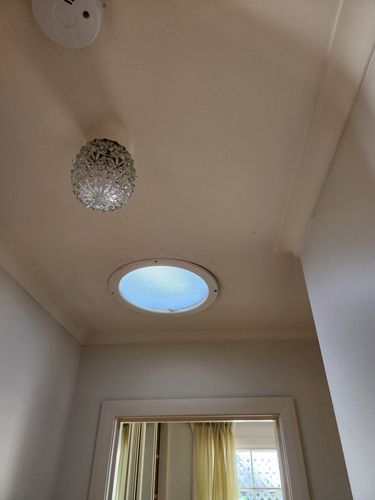

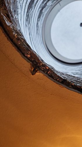

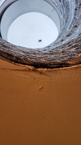

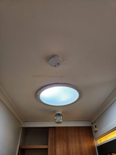

I have just bought a house where there are two skylights where the screws are coming out of the ceiling (I think the holes are too big for them) and the diffuser frame is no longer attached to the ceiling on that side. How can I affix the screws to the ceiling more securely?

I've just tried screwing in the Wall mate anchor but since the original screw hole is too close to the edge (there's less than 5mm), the anchor has ended up splitting the plaster. Are there alternatives I can use when the original hole is really close to the edge? All the wall plugs seem to be too big.

Because the anchoring point is so close to the edge. I suggest getting a small piece of timber around 11mm (h) x 40mm (w) x 100mm (l) and attaching it to the edge of the plasterboard with Selleys 100g Liquid Nails Construction Adhesive specifically right next to where you'll be screwing the skylight diffuser. To hold the timber in place you can also screw it to the plasterboard itself. The purpose of the timber piece is to act as anchor for the screw of the diffuser. Using this method will prevent the edge of the plasterboard from breaking apart, this method can also be used for the other sections of the diffuser if you feel that they are not anchored very well. Please remember to drill pilot holes to prevent splitting the timber piece.
