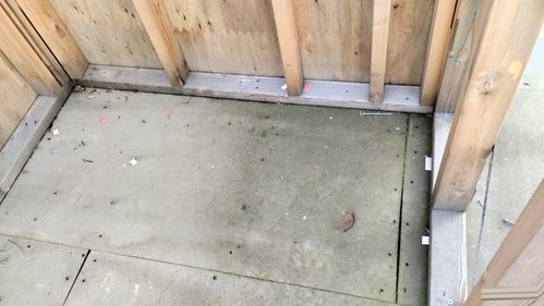

Hi @MitchellMc or Bunnings Team or other experts, looking for some advice from you too. See a photo of my flooring. Not sure if sanding can fix that. This also looks like mould. Any bit of advice from you would be great help. Thanks.
Welcome to the Bunnings Workshop community @Rond. It's brilliant to have you join us, and many thanks for your question about flooring.My advice would be the same as I provided above; you need to have the flooring assessed. Unfortunately, we are not able to provide the best advice purely from a photo. You'll need to have a professional assess the flooring and determine whether it is salvageable by sanding it back.
If you are able to verify whether it is our Structaflor, you can contact them directly and arrange for a sample to be sent to them for analysis. Be aware that their warranty extends to the five-month period for exposure; any longer could lead to issues down the line.
Given the significant cost of resolving this issue later after the flooring has been installed, I would speak with your builder and consider engaging a private certifier to give their opinion on the issue.Please let me know if you have any questions.Mitchell
