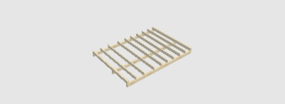

I've uploaded some images to help illustrate my problem. The joist spacing is not correct, nor is the number of joists. It's more to help me visualise what I'm about to do.
Bearers double 90x45
Joists single 90x45
Posts 100x100 H4 posts in concrete or stirrups set on top of concrete, not sure yet. Building on a sandy WA surface.
Dimensions roughly 3m wide by 2.5 deep.

I'd plan your spacing of the joists to align with the walls. It would then simply be a process of screwing straight through the bottom plates into the joist with long bugle screws or coach screws. I've put a couple of renderings together below to illustrate. Sorry, I got a bit carried away; I love cubby houses.
