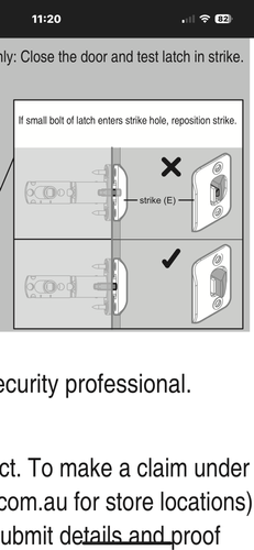

Hi. I have installed the Ikonic entrance door lock to my front door to replace an existing lock. It all lined up perfectly and installed easily but the latch won’t stay in the strike plate - it just swings open even when the ‘locked’ I have gone back over the instructions and can’t see anything I have missed, but I can’t understand what this picture is trying to convey! I have attached pictures of the installed lock for reference. Thanks!

It appears that you've installed the latch in the reverse direction. I propose removing the latch and turning it in the other direction where the slope of the latch faces the striker plate. Once you have it in the other direction it should lock properly.

Thanks so much Eric!
got it working perfectly now😊
