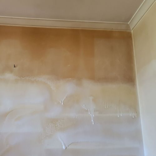

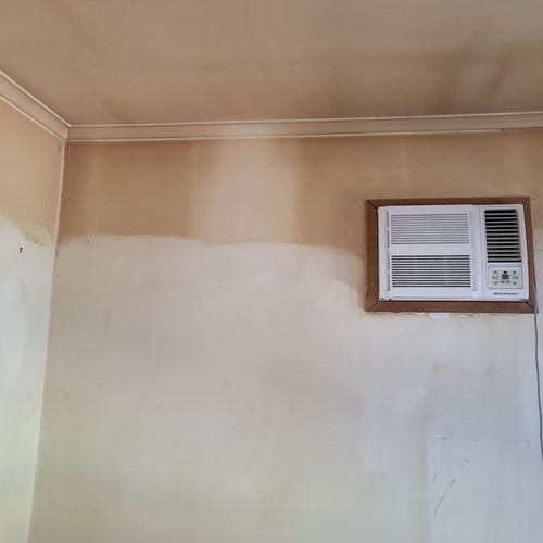

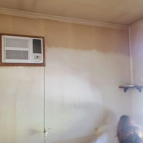

Hi all, we did a mammoth job yesterday trying to clean as much of the walls as possible.
We used sugar soap spray, wiped with damp microfibre cloth then a once over with warm water and a cloth.
I tried a couple of other things but this was the method that worked best and quickest for a large area.
Hi Dave, thanks for pointing me in the right direction for the primer. The walls came up better than expected and we skipped the ceiling as we can just do as you’ve suggested. You saved me a day of labour and a week of body aches!
