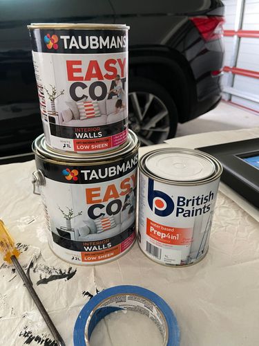

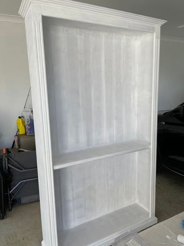

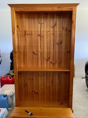

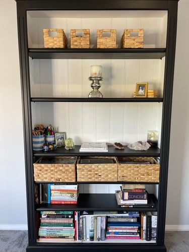

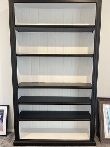

I purchased an old solid pine bookcase 2m tall and gave it a contemporary facelift. First I cleaned and lightly sanded the entire bookcase. Then I used British Paints 4 in 1 Prep to give it two coats all over. This prevents any stain showing through. Once dry I painted the internal back and sides with Taubmans Easy Coat low Sheen in white. Again two coats to ensure even coverage. I used Taubmans Easy Coat low sheen in All Black for the outside of the bookcase and the shelves. I love the low sheen as it’s almost a satin finish. It’s so contemporary without the gloss and it looks amazing in my study.
