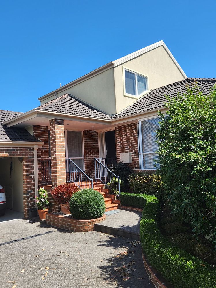

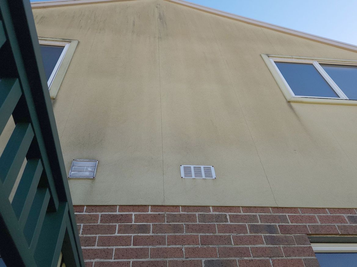

My 22 year old townhouse in Melbourne has rendered blueboard cladding on the upper storey. Every joint between two sheets has cracked render. It has been like that for many years, there is no moisture entering the house, it is just an eyesore.
I have finally decided to do something if I find someone to do it. It won'tbe easy due to the design of the house and poor access from one side.
I can't consider new cladding or re-rendering. There is no room for those options - there is no roof overhang or eaves.
I don't want timber battens - it would alter the look of the house too much.

The pictures may not show all cracks, but believe front
backme, they are there.
