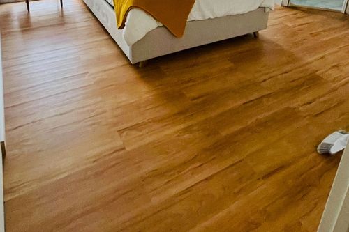

I came across this searching. I just wanted to say please check with Hanwood regards to underlay for your exact product. I used underlay on my Antares Oak 5mm Hybrid which has turned out to be a huge mistake and now have to rip up the floor. It’s designed not to have it. If you do use underlay the click and lock system fails very quickly, see damage on mine. I learnt my lesson and did remainder of the flooring directly on the concrete and is settled and strong.
1st image, crack along the joins with underlay
2nd image, laid directly on concrete . Hope that helps
