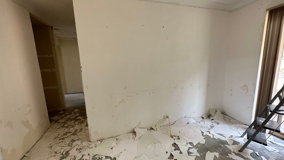

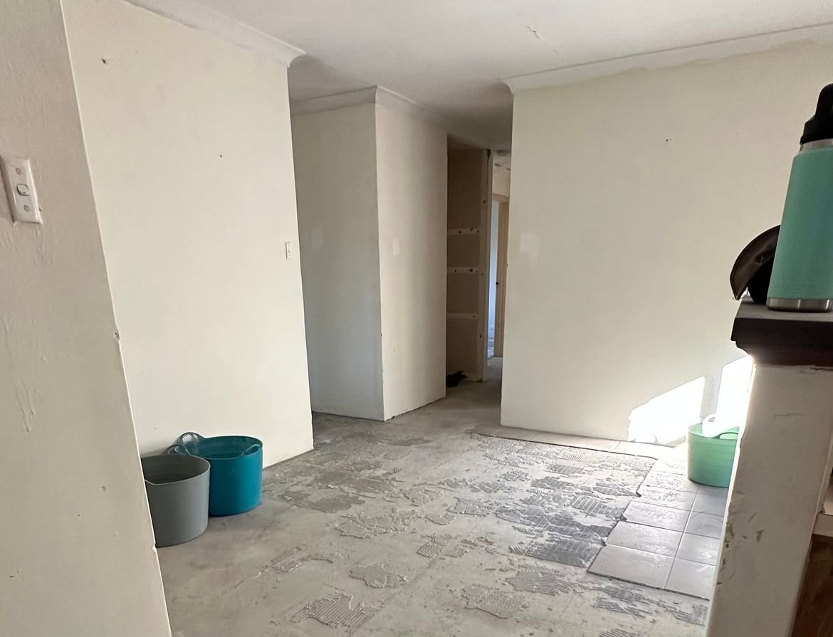

See the photos below of the wall - now with paint removed, and you can see its position as the main view from the kitchen as you look down the hallway to the bedrooms.
I’m then not sure exactly how to install the panels onto the plaster - if I need to install a wood frame to mount it on first, how do I deal with the panels sticking out from the cornice? Ideally, I don’t want to remove then re-install the cornices.

Basically, the panels need to be glued and mechanically fixed to the substrate. To achieve this, you could use stud adhesive per the installation instructions and then screw directly through the sheet and plaster and into the brickwork with Ramset Black Countersunk Masonry Screws. I'd suggest doing a few test areas with the screws to ensure they drive easily into your brickwork.
Unfortunately, both Laminex Surround and Easycraft VJ Panels are not designed to go directly over a masonry wall and do require timber battens. So, if you did experience any issues with the above installation method, it would not be covered under warranty. The concern seems to be airflow behind the sheeting, as any moisture in the brick wall could adversely affect the sheeting.
In regards to setting the sheeting out from the wall with battens and not wanting to replace the cornice, that will become an issue. In order to have a cornice above the panelling, you'll need to remove the current one and re-install a new cornice. As you said, if it's the most damaged cornice in the house, it likely needs to be replaced anyway.

Hi, I'm in Perth too and have a carpentry company. We've been installing direct over plaster for years and I've even discussed this method directly with Easycraft and Laminex and there's no concern beside of course the risk of moisture but that concern is really just at install rather than down the track as Perth is not considered a high humidity location.
Use a high quality sealant and adhesive with a fast grab and apply it in horizontal beads/lines at 400mm centres, run a bead along both vertical sides and one down the middle. Fix into place with 16G brad nails. The adhesive is doing all the work, the brads are just holding the sheets in place while it cures.
You'll find the sheets are same thickness as the bottom of a standard cornice. Leave your expansion gaps and you can fill them with a flexible filler before painting.
