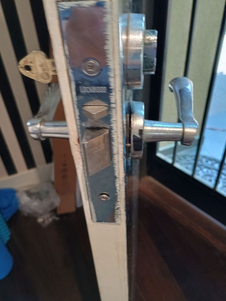

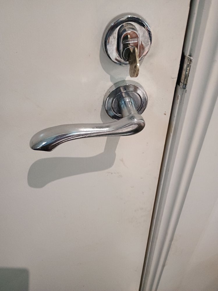

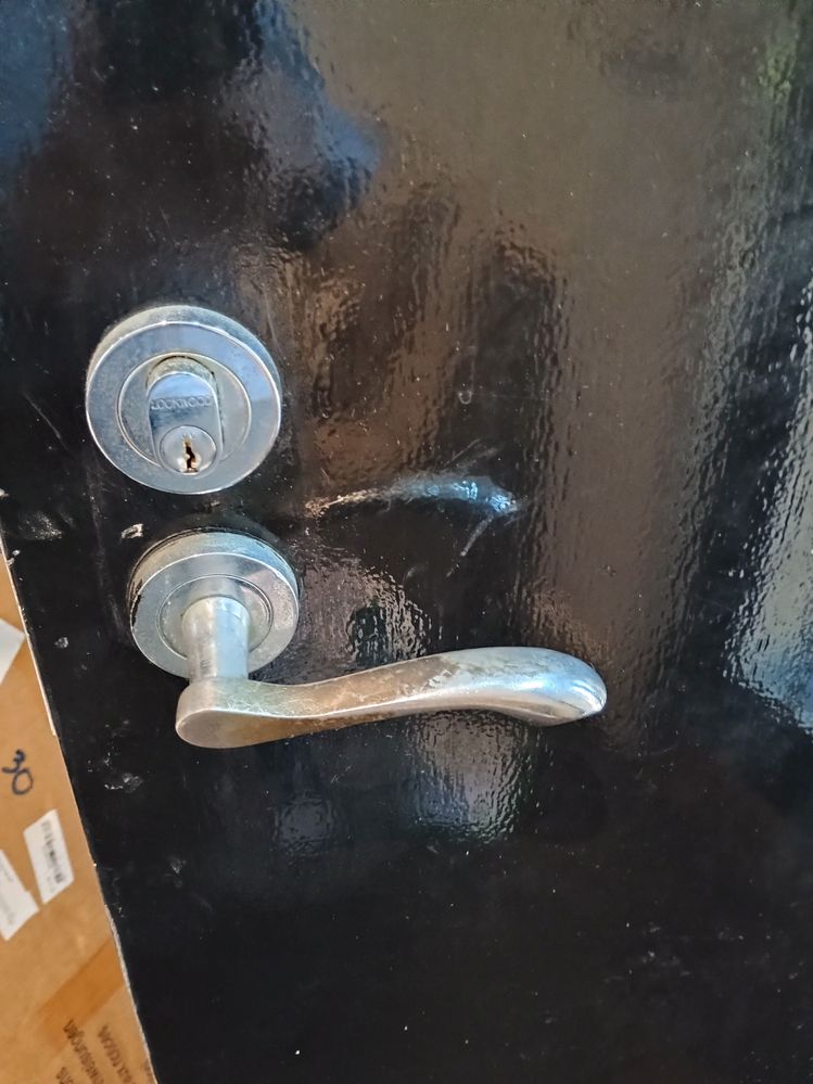

If they did, I'm assuming the locksmith said you couldn't use this lock because you currently have a mortice lock?

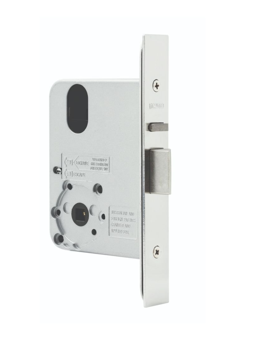

Essentially, behind that face plate, you have a rather large mechanism that sits inside a rebate that is cut into the side of your door. It looks like this.

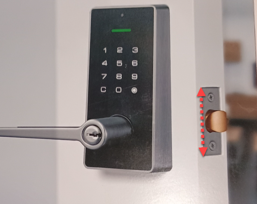

The reason the Lockwood smart lock wouldn't work is that the big rebate on the side of your door is going to be there when you remove the current lock, and the faceplate on the smart lock needs to be screwed in at the location of that large rebate, which isn't possible.
Unfortunately, I am not aware of any smart lock that wouldn't run into this same issue with your door in its current state.
The only option I can think of that would guarantee you could use a smart lock is to replace the door.
If your locksmith has recommended a smart lock that would work, then it may be worth following their advice, because the only alternative I know of that would make a smart lock a viable option is to replace the whole door.
