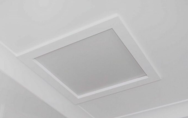

Hi Eric, many thanks for your assistance. This is a picture of the sort of manhole I have:  Screenshot 2025-04-26 154024.png  Would Bunnings have a lock that I can attach to the manhole; a lock that we can lock from its outside (i.e. not a lock that we use when we're in the manhole/roof space, but when we're beneath the closed manhole, and standing in our garage), and something for which we wouldn't need to modify its configuration?

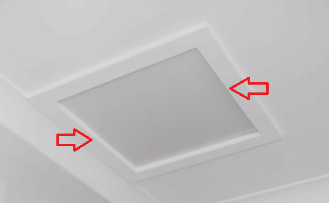

Hi @AussiePossum,
I'd imagine the Delf Satin Chrome Keyed Window Sash Lock would be the easiest for you to install. You'll need two, one on either side (on the bottom), to secure the hatch. Otherwise, it can be picked up from the other side. I've marked suitable locations below.
Bear in mind that manhole covers are typically made of plasterboard, so that would need to be swapped out for timber. To install the locks, you will also need to add small risers to the cover so that the lock is level with the trim timber.
