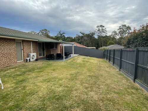

Looking to split the yard and add fencing from the brick house to the wooden fence.
Planning to use protector aluminium panels and posts.

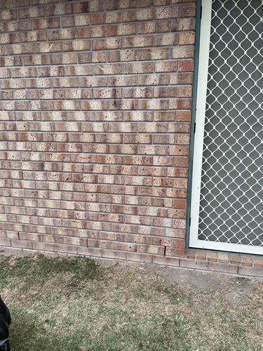

The brick wall is where I want to put the gate. Would it be ok to just have the gate latch go straight in to the brick wall? or do i need to put a fence post on the wall/ in front of the wall?

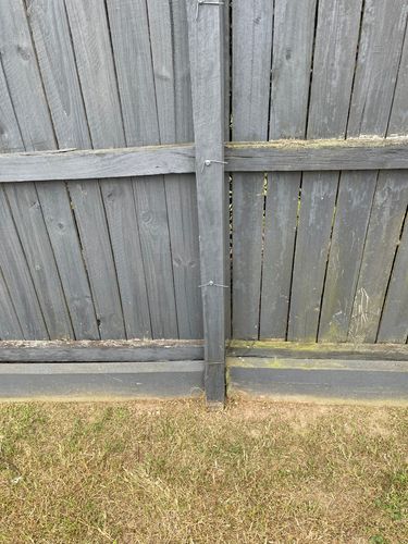

2. Post 2, Not sure if the existing fence post is sturdy enough to attach fence panel direct to it.. should I attach another aluminium fence post to it or just before it?

I suggest the first thing to do is measure the area and plan out where the panels will sit. This will have a lot to do with which posts need to be installed and where. You might find the panels finish 100mm from the wall or timber post, which would mean that you have to add additional posts. If the panel falls right at the wall and post, you could connect the latch or panels to them.
I'm not sure if you've planned this out, but Protector fence panels can't be installed at an angle. So, you'd need to progressively drop them down in height to accommodate for the slope. However, there's nothing you can do over the panel's width, so there will be a large gap underneath them on the lower side. The only way to get around this is to level the soil under each panel, but that will cause its own issues with erosion. You might like to enquire with the team at your local Bunnings Special Orders desk. Protector Aluminium does custom panels, and they might be able to design something to suit your needs. Simply supply a diagram to the Special Orders Desk and they'll pass it onto Protector Aluminium to see if they can custom manufacture fencing that will meet your requirements. Please also supply your name and contact details so they can call you to discuss any particulars.
