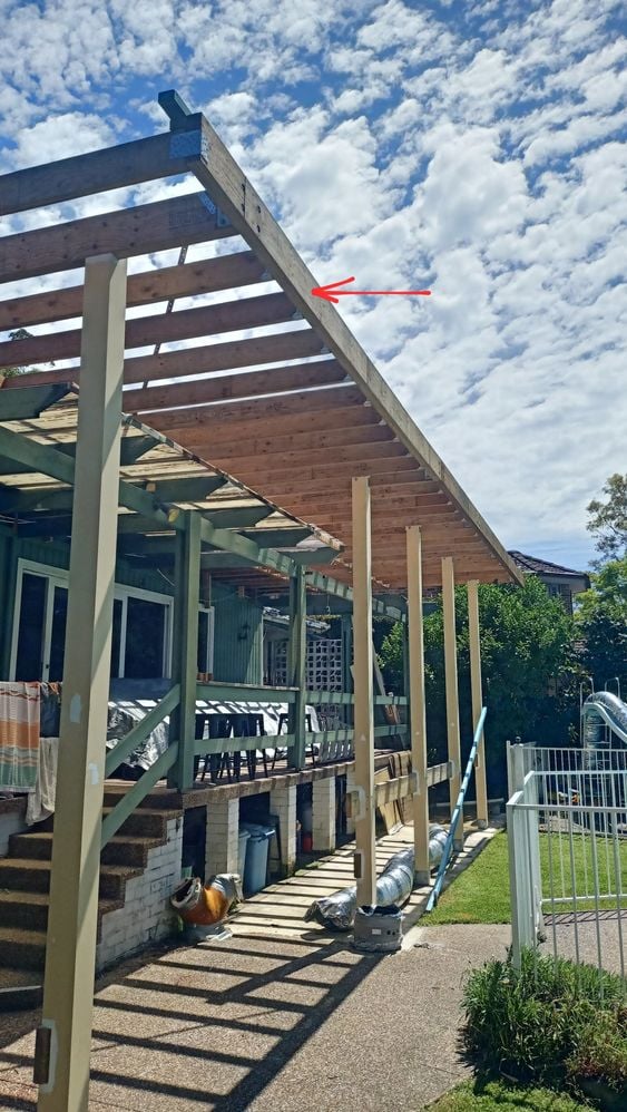

Working on a flat roof extension for a large undercover deck (not enclosed).
What would you call this end beam?
Its a 200x63 LVL tying all of the rafters together.
Secondly, how would you go about installing a metal fascia and ceiling cladding/soffit in this situation?
Standard fascia clips won't work since the rafter ends are not exposed.
So... maybe screw a timber fascia board over the top then proceed as normal, or attach a metal fascia cover and guttering directly onto the beam? What would the soffit/ceiling cladding sit on where it meets the fascia?
Appreciate any ideas/insights.
