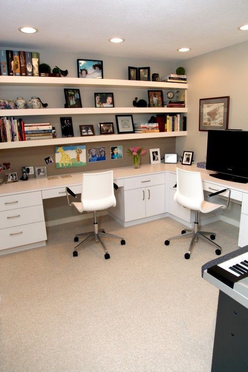

I am thinking about renovating my home office, but unsure whether it is feasible to join Specrite panels into long desks.
The image below describes the general idea I have. Essentially I want desk panels running along the length of two walls, that connected to base cabinets. These would run 3200 x 2900. These panels - https://www.bunnings.com.au/specrite-2400-x-900-x-33mm-brown-acacia-multi-use-timber-panel_p0472677 look ideal, but since the maximum length is 2400, I would need multiple.
