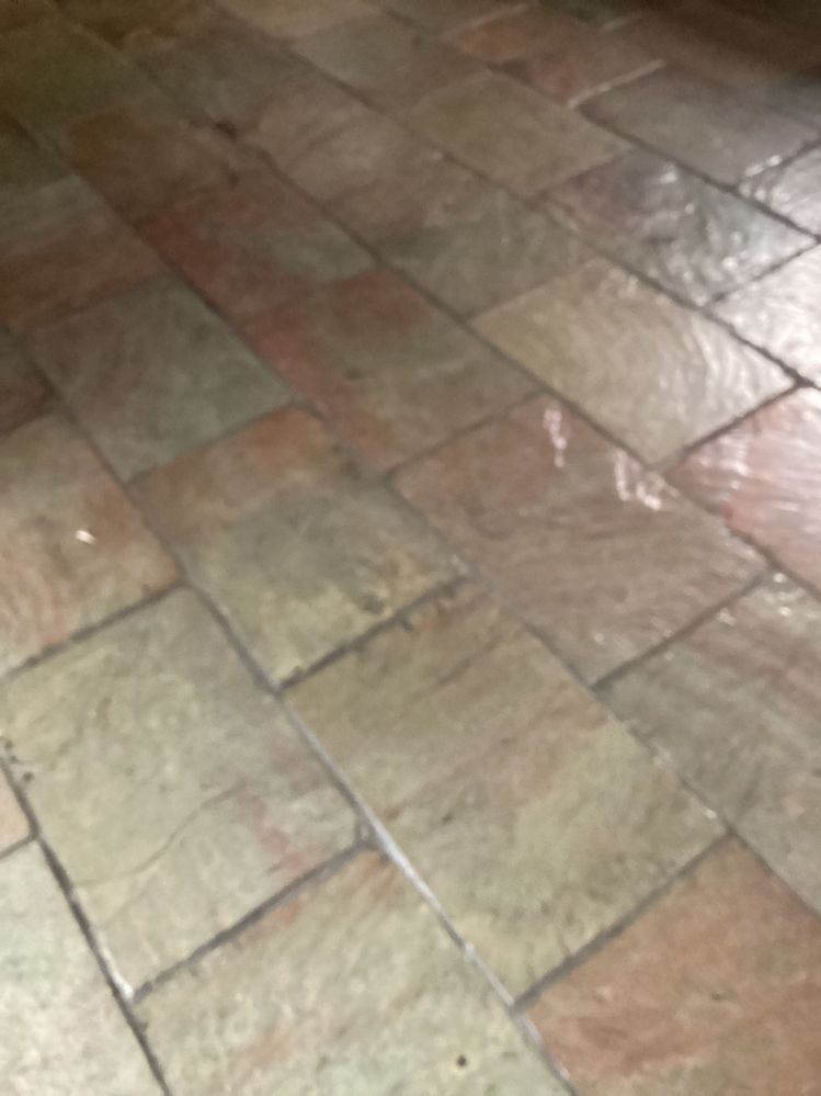

hi everybody I have unfortunately slate tiling throughout my house with hardwoods as well, desperately want to put laminate flooring over the top of both. I got one craving and that was to use Self levelling for 80 squares costing around $4000, Has any body had any experience or know of about a glue that pretty much does the same thing filling in the uneven floor surface, would like to have a price comparison before I book anyone in to do the job.

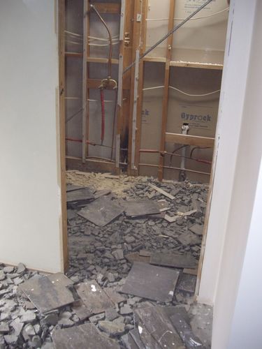

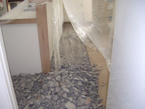

I have also done a floor that originally had slate down. It's a big job that I recommend hiring a decent (not too heavy) pneumatic chisel. The process will cause a significant amount of very fine and harmful masonry dust. So good quality PPE is a must. As is sealing off all adjacent room very well. The fine dust will make its way through the smallest open space and is time consuming to clean.
It will be a very labour intensive job to remove the slate and clean the underlying slab. But a few days hard labour will only cost you the hire of the tools of around $250 vs $4000 for self levelling compound which without going in to more detail will only end up in a larger can of worms including resulting in a  finished floor higher than the connecting rooms.
