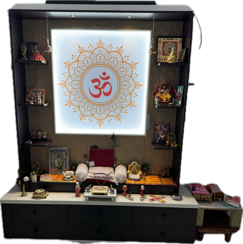

How do I can make wooden 1800mm (L) x 500mm (W) x 450mm (H) with 3 table doors cabinet with 2 MTR hight back frame? I have attached a photo of that.

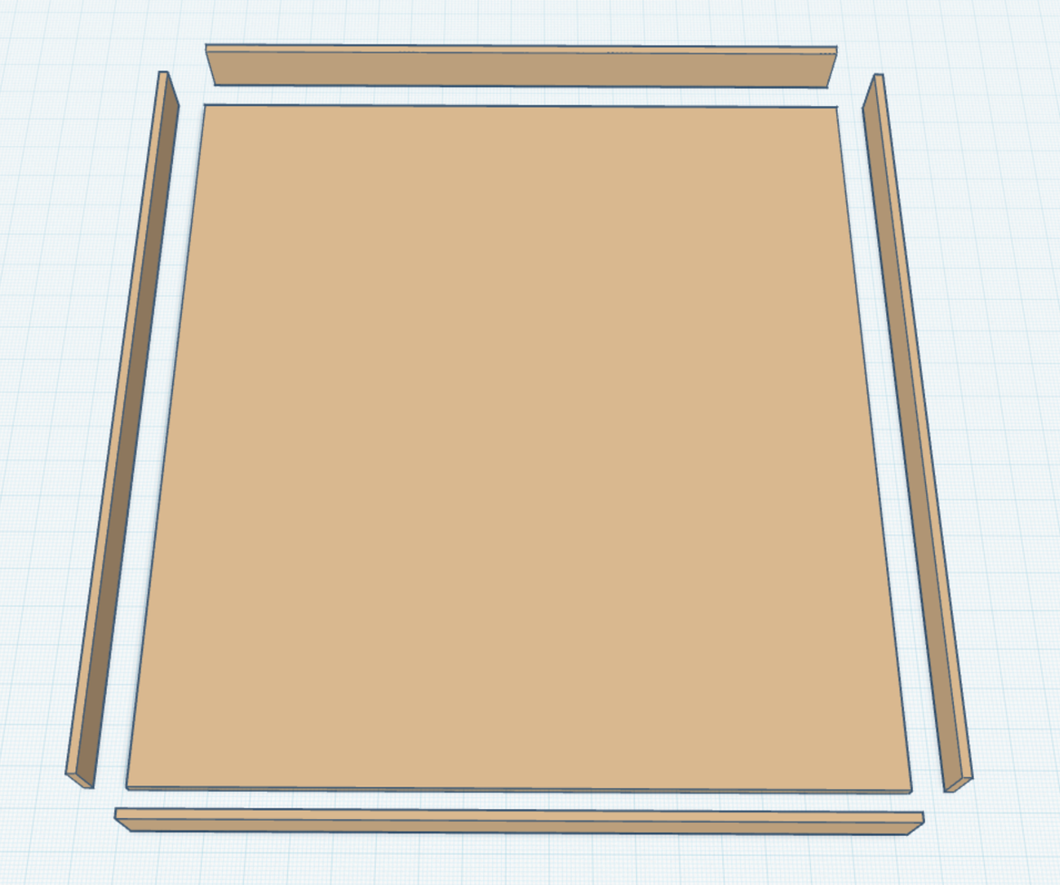

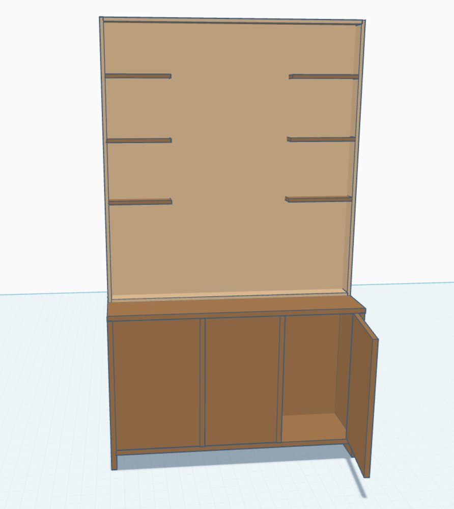

For the cabinet itself, it’s often easier and more cost-effective to purchase a ready-made three-door cabinet in the style and dimensions you’re after. This gives you a solid, level base to work from. The rear display section, however, is definitely something you can build yourself. Start by creating a rectangular frame at your desired height (2m) using 140mm-wide timber, securing the corners with screws. Then, cut a sheet of 3mm MDF to size and nail it to the back of the frame to add rigidity. Once complete, attach the frame securely to the top of the cabinet and fix it to the wall behind for stability. You can then customise the back frame by adding shelves, hooks, or hanging points to suit your setup.
I've created the rendering below to assist.
