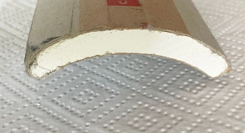

can you take a picture of the profile (the end of a cornace piece) So I can try understand better thanks Not giving up on you yet ![]()

It is a very uncomplicated cornice as you’ll see. It’s basically semi circular with a very small flattened section on the back; this flattened bit obviously isn’t really relevant. Hopefully when it comes to the practice my concerns will feel misplaced! Thank you again.
