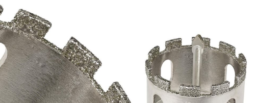

The hole saw you will need is diamond tipped along its rim. Don't bother trying to cash in on the diamonds, as they aren't' that type (I've tried). Instead of a traditional drill bit for a pilot, they use arrow headed TCT bits that are spring mounted, so they depress once the hole is started.

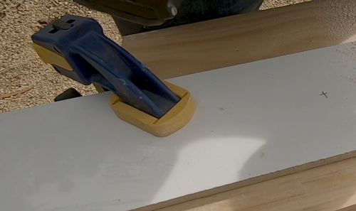

In the case of tiles, ensure the tile is clamped to a flat clean surface, like a scrap of dressed pine board. The board also supports the tile in preventing it from breaking during the cut.

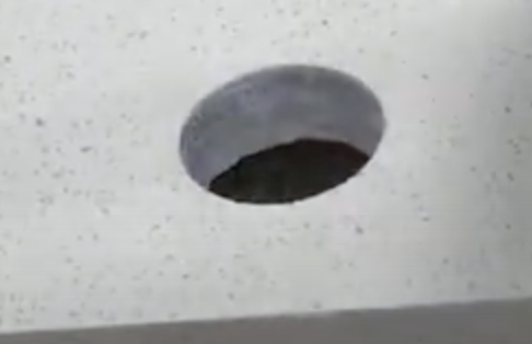

Making holes in stone bench tops will be after installation.

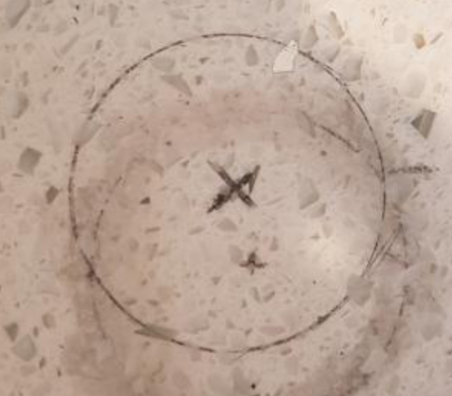

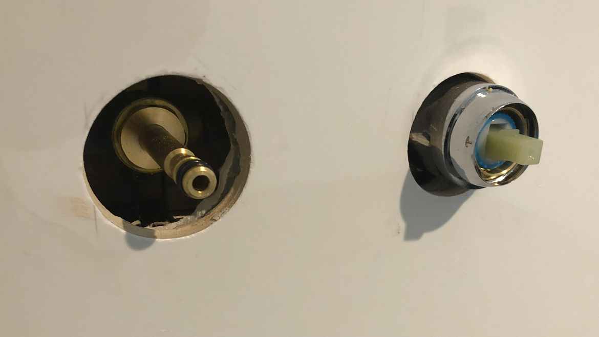

Once you have marked your holes, fit the Holesaw into your drill/driver. If your drill has a side handle option, fit that so you have increased control during the cut.

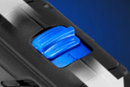

Then select low range from the gearbox. This maintains a slower speed but high torque (twisting power).
If you have used holes saws before, you know there is a reliant on the pilot bit to get you started. In my experience you can ignore the ones that retract (I don't know the reason) because they provide zero guideline in the all important getting started. This is the brand that I used, which I have found to be excellent in clean finish and durablity.
Now's the time to put on your PPE.
With a firm grip on the drill, start by holding the saw on a slight angle as you lower it to the tile with the drill running at a medium speed. This technique of starting does take some practice on spare tiles to stop the saw from wandering.
Once the rim has taken, then start to roll the rim around in a wider circle to start with and then reduce this as the saw gains depth. Then straighten until the saw breaks through. This same technique also works on cement sheeting.
I might add some brands of saws allow for both wet and dry cutting. So for thicker and/or denser tiles, I would use water to help keep the Hole saw cool which will extend its life and will result in a cleaner cut. You can spray water on the saw while you making a cut via a helper or make a dam as explained in the next step.
So my two major tips are to practice first and unless you have a fixed pilot bit, don't attempt to start off drilling square on to the surface.
The technique for drilling into stone bench tops is the same. However it's a slower process due to the thickness of the material. So this will overheat the Holesaw.

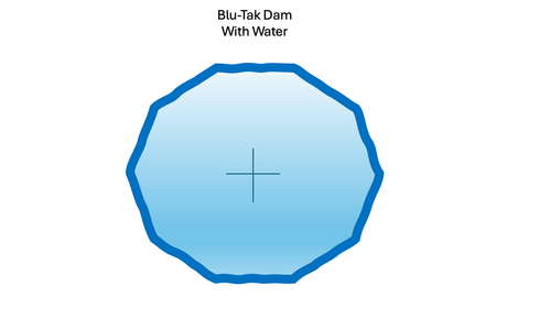

To keep the heat and reduce dust by making a dam using Blu-Tak or similar about 150mm in diameter and pour a small amount of water in it.
