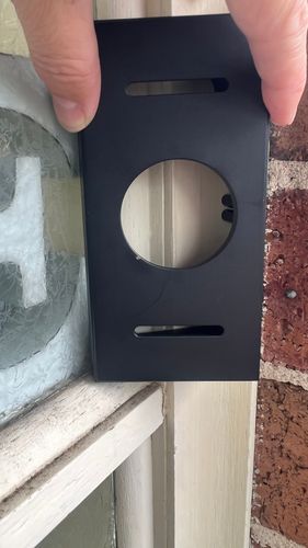

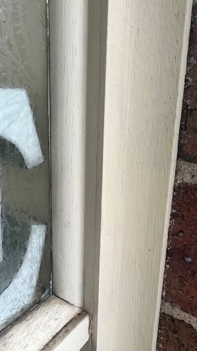

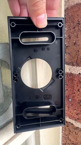

so, I purchased a “ring doorbell” but the only place I can mount it has a curved wooden panel. Any ideas how I can make it straight to attach the mount for the doorbell? I was thinking spac filler, or something similar?

Is there a reason why you can't install it onto the brickwork? Perhaps there's something unique about your model, but from scanning other Ring installation manuals, it appears that fixing to a masonry surface is an option.
If you wanted to mount right over the scotia moulding, I'd suggest screwing on a flat piece of timber first. Once you have a flat surface to work with, you'll easily be able to mount your doorbell. I've included a rendering below to illustrate.

This is perfect! The brick is to far out of view as a pole for the awning blocks the view. I knew you would have a practice simple solution!
off to Bunnings I go. Would you have a suggestion for timber type? Would there be anything that pre exists in a small size. Namely 12.8 a 6.2
No small pieces that I can think of @Misvtec. You might be best off asking a team member in the timber yard if they can cut 13cm off the end of a Porta 66 x 18mm 1.8m DAR Meranti Standard & Better. That will give you a piece of 13 x 6.6 cm which would be very close.
