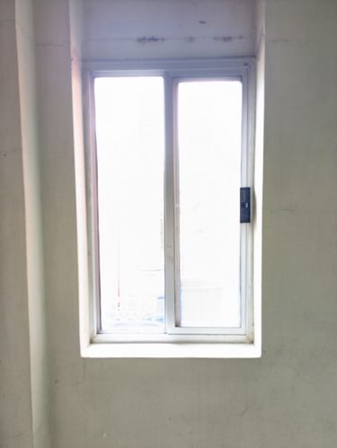

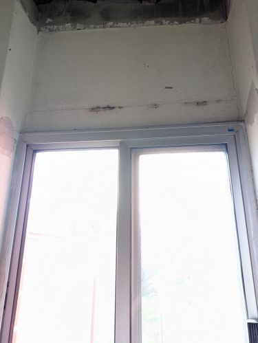

Here are photos of the wall. There is rust above the window, perhaps indicative of a metal lintel? I would still like to keep the window if possible.

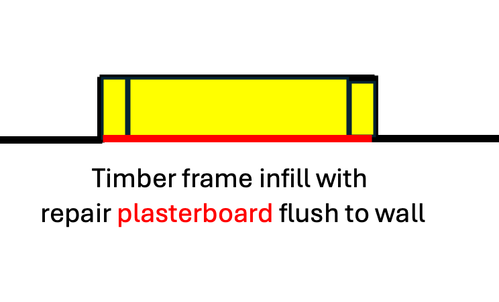

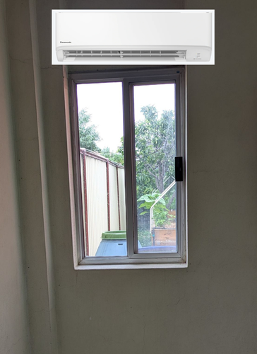

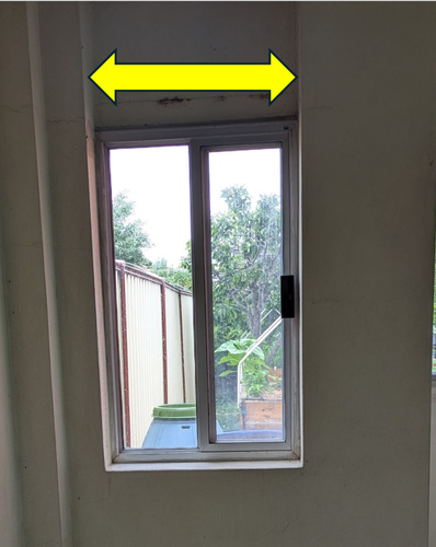

There should reason that the window can't remain in place. The issue is the rebated wall that continues above to the ceiling. This is assuming the head unit of the split system is wider than your window which looks to be around 450-500mm wide. This means you will need to fill the void above the window for it to be secured to as well as it will be fixed to the hardball either wise. Plus it's needed to conceal the pipes through the external wall.
A basic timber frame fitted with plasterboard flush to the side wall and returned back under. I would start this at the lintel line to kill two birds with one stone. You can buy small pieces of repair board that should do nicely fixed to 70mm x 45mm pine. Pre-drill the frame with pilot holes to accommodate fastening screws driven into nylon masonry plugs. You will need to gap-seal the edges of the plasterboard, prime and paint.
The head unit will be mounted by the plumber and the pipes will run external down one side of the window so won't be see internally. The sparky will need to install an external GPO to run the compressor sitting on the ground under the window. The plumber will have a sparky he works with for AC installs you can use.

Void to be filledVoid to be filled
How the head unit will sitHow the head unit will sit
whats required that you can dowhats required that you can do
