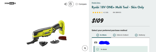

All good ideas from @EricL and @JDE , here is a last resort idea, if you have a multi tool, you could cut along the painted edges of the widows to separate the the painted joints. You shouldn't have to go in very deep, I think the Stanley blade would do the trick as suggested by @EricL @JDE
