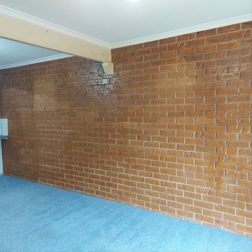

Hi
I'm trying to paint brick walls inside my house.
They're really orange and glossy.
Any recommendations on how to paint these walls white? I really would like to tone down the orange and spend as little as possible on this project.
Thanks!

Done!
Sorry @eileen92, any chance of a higher resolution image so we can see the surface of the brick? From your description, it sounds like they could be glazed, which I suspect could affect what products are recommended as it could be a difficult surface for paint to adhere to.

here you go 🙂
Hello @eileen92
Thank you for sharing that extra photo of your tiled wall. I suggest using the Dulux Renovation Range on your tiled wall. It can be used on ceramic and porcelain tiles, laminate, vinyl, PVC and other plastic-wrapped surfaces.

Now that I 've had a second look at your glossy wall, is this exposed to the outside? If it is, then you won't be able to use the Dulux paint as it is for indoor use only. That shiny surface on your brick wall is that because it's a tiled brick wall or is it a sealed brick wall? If it is a sealed brick wall, I'll need to recommend another product for your project.
Any extra information you can tell us about the composition of your wall would be very much appreciated.

They're all indoor walls and not exposed to outside.
I have no idea where the gloss came from.
How do I tell if it's tiled or sealed?

A quick way to tell if it is solid brick is to scratch the surface of the brick with a nail. When you scratch the surface, you should just see brick material, but as you continue to scratch, and it changes colour to either white or grey then that will tell you that it is a tile. I suggest testing a brick that is not in direct line of sight and is out of the way.
Another way is to check the exposed edges of the brick. A real brick will be a solid form in brick colour, where as a tile will have visible joins when turning a corner.

Ohhhh if the question is whether they are real bricks, then yes they're real. The house is a brick house.
Thanks for that information. It's likely that your brick surface has been covered with a clear glossy sealer. Technically the sealer can be painted over. However, please note that should the sealer fail, it will take with it whatever's been painted on top of it.
I suggest using either the Zinsser 3.78L Smart Prime Undercoat or Dulux Precision Maximum Strength Adhesion Primer. Please note that the Dulux Precision will need to be ordered at the special orders desk.
Even though these primers are supposed to go on to glossy surfaces. It is still prudent to sand the surface of the glossy surface to provide an excellent base for the primer. Once the primer is on and has cured you can then paint it with your choice of water-based topcoat.
