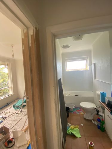

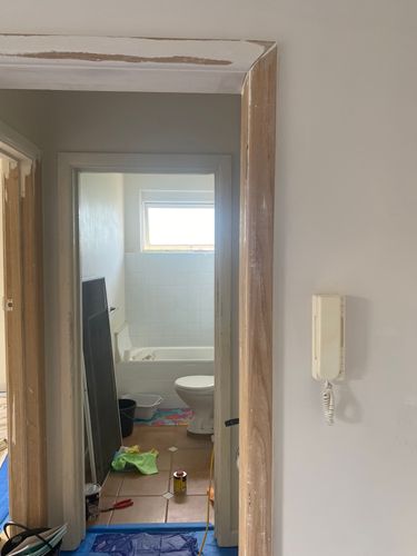

Hi Bunnings Community,
I’m having trouble with some uneven surfaces on the architraves in my flat. I’ve tried paint stripper, scraping and sanding, and it has turned into a bit of a mess. I can’t continue sanding because the old paint contains lead, and even with a mask I’m worried I might be exposing myself to dust.
At this point, some areas are back to bare timber, others still have paint, and there are multiple layers visible. The whole surface is patchy and bumpy.
As a solution, I was thinking of sealing the entire architrave with Peel Stop or Dulux Sealer Binder, then applying an undercoat in two stages — first spot-priming the bare timber, then doing a full undercoat over everything. Finally, two coats of topcoat.
Is this a good approach?
Any other suggestions for dealing with the uneven surface? Also, what undercoat would you recommend?
Thanks!

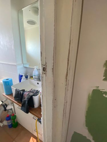

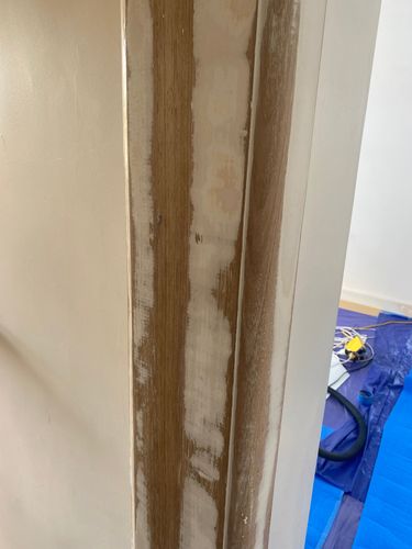

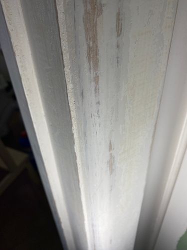

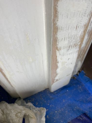

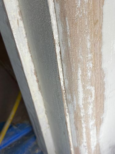

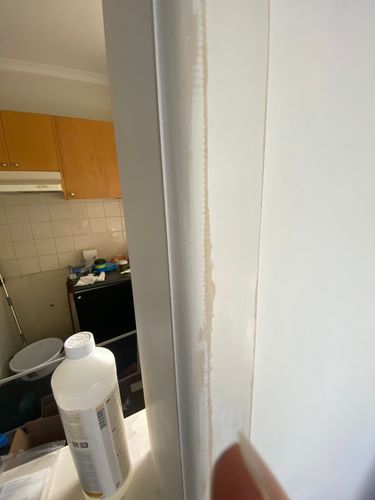

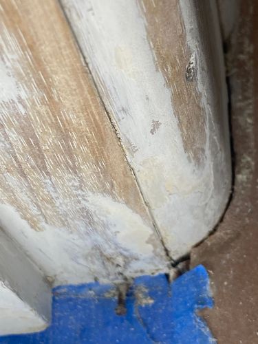

hi again @MitchellMc  Sorry to bother you again,. I just wanted to show you some pictures of the results of my scraping because I’m still struggling. If you look at it closely especially in the crevices, it is all still very bumpy and flaky, I keep scraping but it doesn’t make it any smoother. I also used a detail sander (ryobi) but it’s hard to get some bits smooth. Would it be possible to put some peel stop over this followed by a couple of coats of undercoat, then topcoat? Or do you think it’s too bumpy and the result will be uneven?
I also noticed that the paint in the crevice between the architrave and the jamb seems very gooey and gummy. Would you say that that’s because this is the bathroom door and it’s got moisture in it? Now that I’ve pulled out that paint, there now is a visible gap between the jamb and the architrave, and between the jamb and the stop, it looks like long vertical gaps. Will I need to fill that with wood filler? or will it be okay to just paint over it?
also regarding paint, I got some Dulux one step prep as the undercoat and Porters Aqua Marine water based enamel for the topcoat. But I was thinking does the bathroom door need a different kind of paint, something specially formulated for wet areas?
thank you

I propose using sandpaper with a lower grit such as 140mm up to 180grit and finishing off the surface with a 240girt sandpaper. I recommend using a detail sander in order to get a flat level finish. If the gap is quite large it would be best fill it with timber filler. I often recommend using Dulux 1L Aquanamel Semi Gloss White Enamel Paint for doors and trims. But since you are using an enamel-based paint for the door it will work just as well.

i had been using a detail sander. Mitchell said I should scrape instead of Sand because of the lead in the paint. The results you see in the photos are from the result of:
1. applying paint stripper and scraping
2. then sanding with a detail sander
3. then more scraping
still very rough in the narrow bits/joins after many many many hours of work.  I’m wondering  how a professional painter would do it because I think there’s no way they would spend the amount of Hours on a door frame that I’ve spent on this door frame as it would not be financially viable, I feel like I’ve done something wrong,
Any advice would be appreciated.
Re: painting on uneven architraves
A professional painter likely wouldn't go to the extent you have, @maro. They would sand and feather any obvious distortions and paint over. As you've mentioned, the amount of labour involved in fully restoring the door is extensive.
My advice would still be to prime the frame and then work on the areas that stand out and need more work. Coats of primer and paint hide many of these small defects. Without at least priming, you don't really get an idea of what will be covered and what won't.
