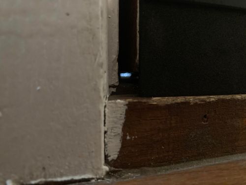

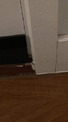

Hi all,
I have recently noticed a ~8mm gap between my front/entrance door trim on one side and the floor. This results in quite a large gap which I am hoping to patch up now it is starting to get a bit colder. I found this thread (https://www.workshop.bunnings.com.au/t5/Whole-of-House/Gap-between-door-trim-and-flooring/m-p/77017) on a similar issue, but am unsure if the solution suggested is 100% applicable in my situation. There are some nails between the trim and the floor so I won't be able to get a nice single piece of plywood cut out, will probably have to do in 3 sections.
I think I will also need to replace the door seal as it is not sealing perfectly - in the interim would thick draught tape on the bottom of the front door be okay?
Thanks
Offending section - on door hinge side

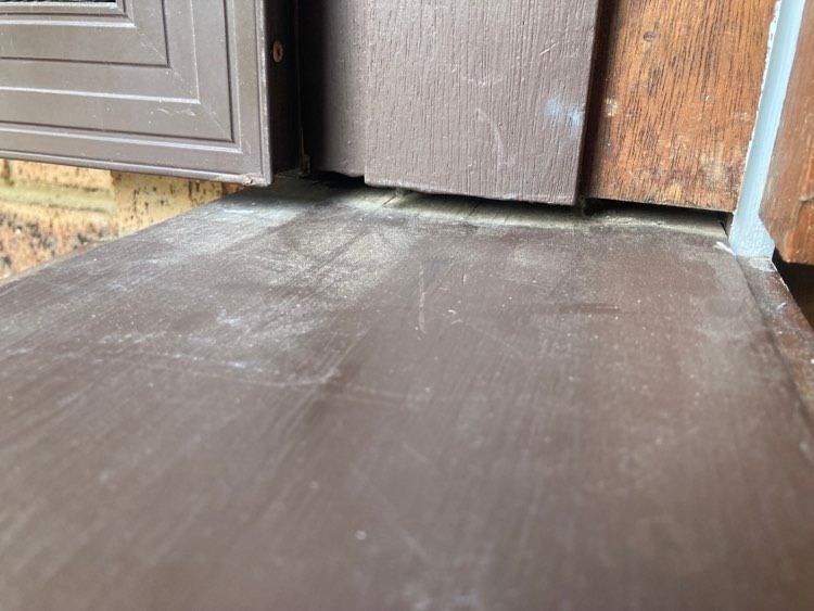

Gap when door closed (incl. gap under door seal)

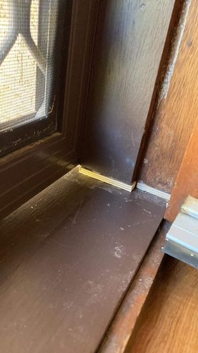

Gap with screen door closed
Hi @lm4,
You won't be able to use a moulding in your case, but you could certainly cut some plywood to suit and slip it in the gap. A few slots corresponding with the nail positions should allow you to do it in one piece. Apart from timber to fill the gap, you could just use a caulked sealer similar to Selleys 480g White 3-in-1 Silicone Sealant. You can pack the gap out with scraps of timber and then caulk a bead of sealer to finish the front face. It's easily smoothed off with a moist finger and can be painted to blend in.
Draught tape would possibly work for your door, but there are some really quick and easy-to-install door seal options, like the Moroday Silver MDS2B Econo Self Adhesive Door Seal. Simply cut it to size, stick it on, and you're done!
Hi @MitchellMc

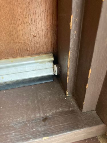

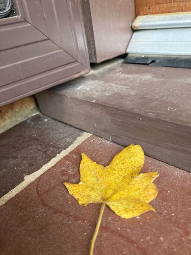

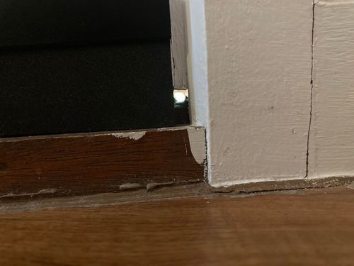

Thanks for your response. We installed the recommended Self Adhesive Door Seal which definitely is helping seal the majority of the gap underneath the door. There are still gaps on each bottom corner of the door which we will have to fix up with the plywood/sealant, and also replacing the outside door seal flap. I think the current one is cut a bit short, and the "knub" should be on the hinge side not the opening side?. Does this sound right? The way it is currently installed looks to actually be flexing the door inwards creating more of a gap, rather than just forcing the seal down.
Door Seal
Gap on Open Side
Gap on Hinge Side
External Gap on Open Side, Knub pushing door in
External Gap on Hinge Side, Plywood and New Door Seal needed

Great work @lm4.
You could try changing the side of the knub, but it could also just be the seal being worn out. It's likely become quite stiff over time and is not conforming as it should.
Hi @MitchellMc
Ended up patching up the gap with some plywood and wood filler, has worked out alright and the hinge-side gap is well and truly gone which is good. Just need to tidy it up a little bit and paint to match the frame.
Cheers
Hi @lm4
Thank you very much for posting that update, it's good to see that the gap has been repaired. Once you paint that patch you won't even see the repair job. My only other suggestion is to double check your door seal at the bottom and make sure that it covers all the gaps.
