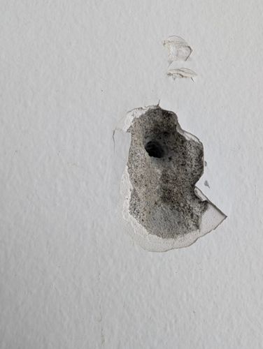

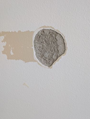

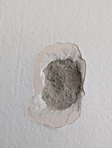

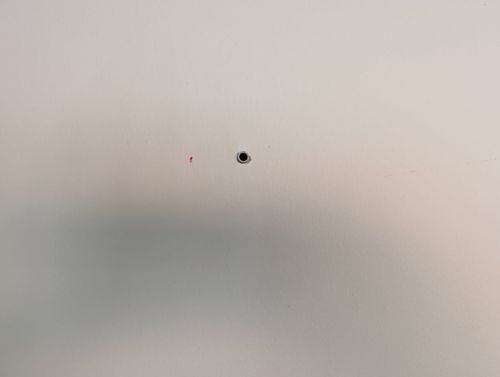

Thanks @JacobZ . I have uploaded images of the project. Thanks
Re: internal concrete wall patching
Hi @Benk,
You've got two layers here: the base layer of concrete, with a thin skim coat of plaster over the top.
You can use the Polyfilla Exterior Brick and Render Masonry to fill the depressions in the concrete.
Once the masonry filler has dried, you can then use Gyprock Less Mess Topping Compound to apply a smooth layer over the top.
Once dry, you can use a sanding sponge to get everything perfectly smooth before priming and painting the patch.
