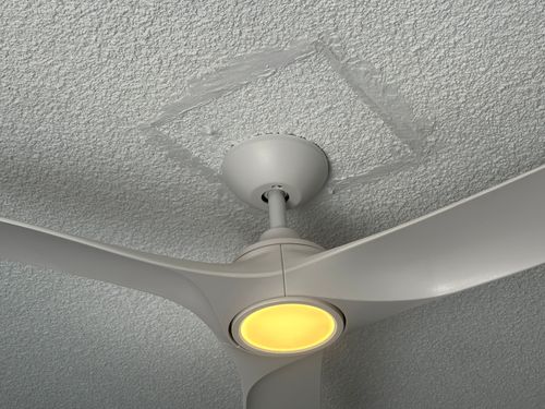

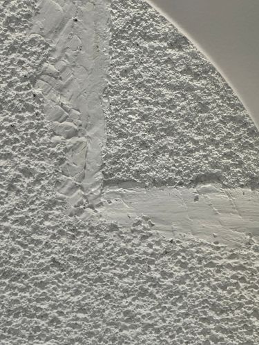

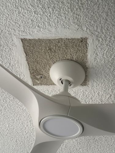

Hi - how did this go? Have a similar scenario. Removed old light and had fan installed. Have used a sponge 🧽 to dab paint on the popcorn. Now have the eyesore of where someone applied some kind of putty. Any insights appreciated. Thanks

Hi @toby8,
Allow me to tag @conicalfern to see if they carried out a repair and how things turned out.
Hopefully, they will respond shortly.
Unfortunately, in your situation, it would be more difficult as you already have texture on either side of the join. If you were to add more along the join, then you would end up with a substantially raised area. So, to account for this, you would need to scrape back the texture on either side of the join to have any hope of the method I mentioned above working.
If you wanted to do this, you would need to confirm that the popcorn texture is not an asbestos-containing material prior to carrying out any work on it. If there is any asbestos, do not touch it and speak with the professionals.
