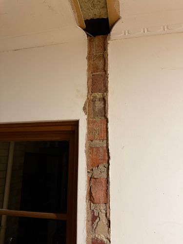

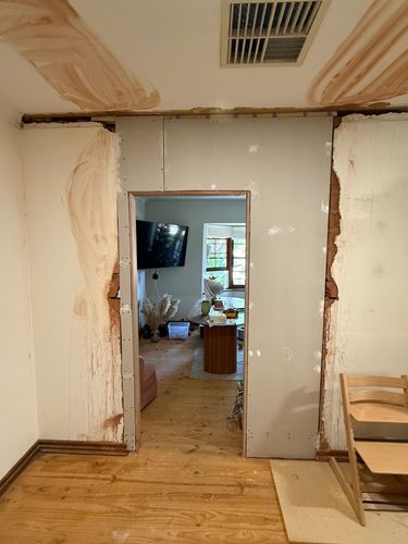

What is the best way to “plaster” a brick wall to tie into both exisiting plaster or new gyprock. What product/s should I use to fill and level. Is normal gyproc 45min ok? Or would I need to use a sealer or mortar first for covering the bricks. The location is internal in a living room, a kitchen and a dinning room.

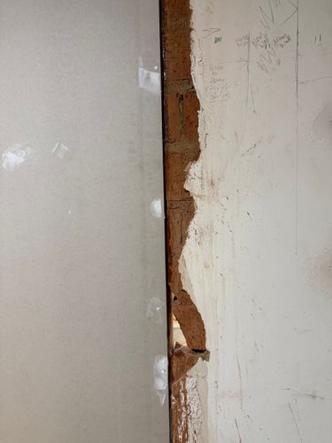

Sorry that didn’t really answer my original question. So the brick gaps are deeper than 10. So for the next coat would I just put gyprock all purpose on top of the render to get it ready for painting? That way I can sand it. Assuming the render you can’t sand?
Re: How to plaster a brick wall to tie into both exisiting plaster or new gyprock?
Hi @Dan4,
I have a solution that is similar to @EricL's and will get you a nice smooth transition between the bricks and the existing plaster.
Use Dingo Structural Repair Mortar to fill the gaps in the brick, then use hardwall plaster mixed with hydrated lime as a topcoat over the repair mortar. The repair mortar will take up most of the space, with the hardwall plaster and hydrated lime mix acting as your topcoat that can be trowelled on smooth and then painted.
You will have some ability to sand the hardwall plaster mix, but if you can't get it perfect, you can always apply a skim coat of Gyprock CSR Less Mess Topping Compound over the top, then sand to get it perfect.

Thanks for your advice. To be clear am I only using the joint tape between the brick wall join and the plaster? Or is it being imbedded all through the hard plaster?
Hi @Dan4,
Just at the join between the brick and plaster as this is a point where two different materials meet and there is potential for slight movements.
It will add strength to a point where cracking has more potential.
