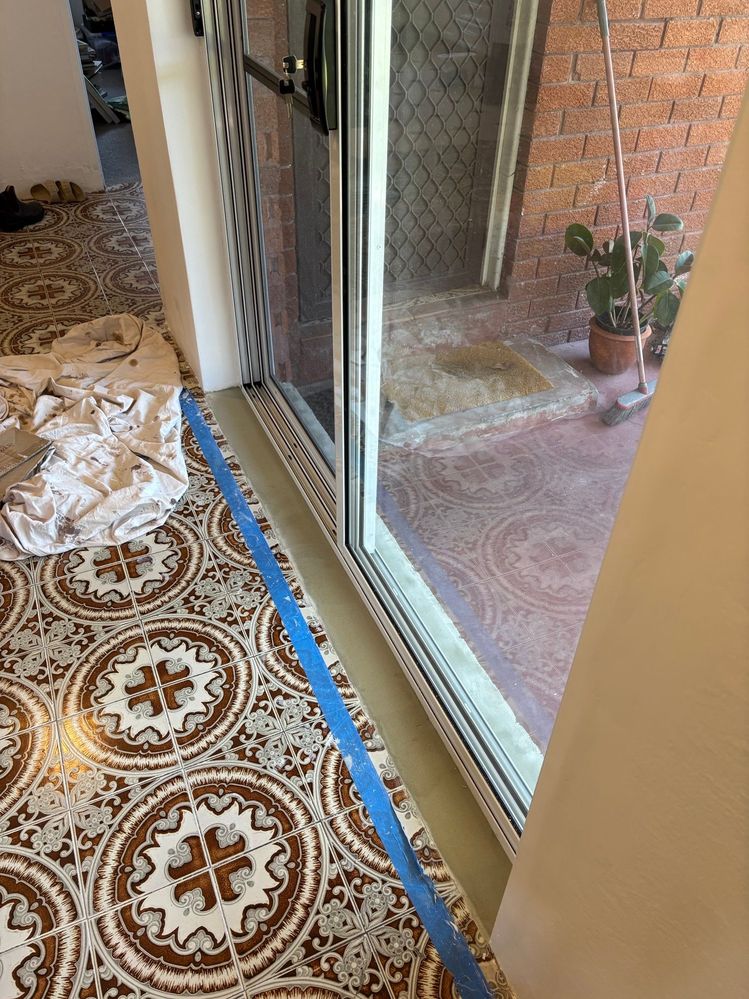

We have just had a sliding door installed and need to finish it off.
Please advise on the best method and products needed to render/plaster the exposed recess.
It's currently quite an uneven surface, between 2-20mm difference.
We also need advice how best to fill in, or cover the void in the floor ( 30mm deep).
We do not have any of the original tiles spare!
Would prefer to avoid wood panelling etc in order to match other windows in the house.
Thank you!

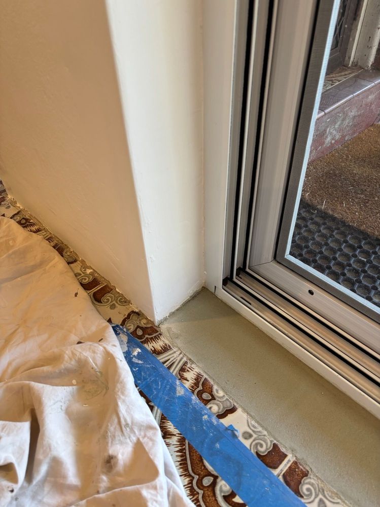

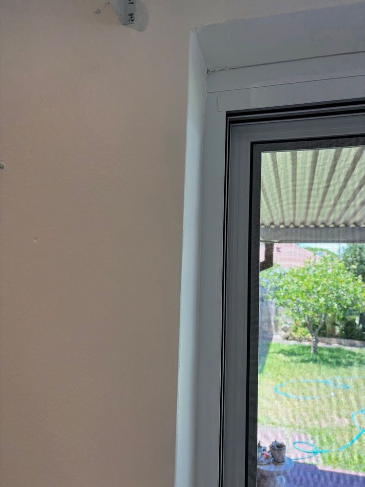

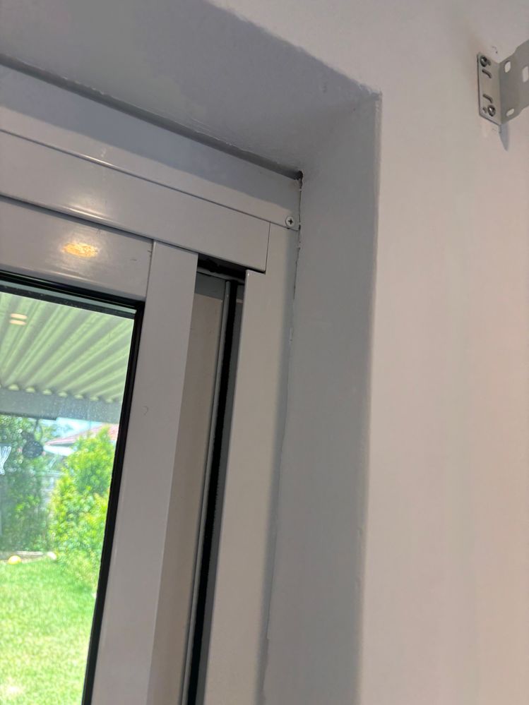

I managed to finish off the job as per @JacobZ method.
A few skills to get across, none of which I mastered, but happy with the result.
That looks like a mighty fine result to me @WhichAisle.
Nice work and thank you for sharing the results. I am glad I could help out.
