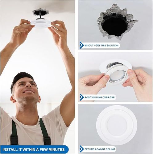

Re: best way to plaster around downlights
Hi @rorycarr,
Your sparky mate goofed and what you need to fix that is - Goof Trim Rings 🙂
I had the same job last year but they wanted the older larger lights (larger holes) above the kitchen sink replaced with the regular LED lights available these days. I never used the goof rings because I found trim rings in one of my lighting crates.
You may need a 2nd ring in the ceiling if the spring retainers can't latch onto plaster.
Cheers
Hi @rorycarr
Goof rings (?) are an easy fix if they cover the area you have problems with. If you don't like this option then you have to find a backing for your repair and the simple answer that springs to mind is a thin plywood or even some more plasterboard (the reason I suggest plywood is that it is thinner than plasterboard and may be able to accommodate the spring clips of your light fitting without modification). Cut some to suit the repair radius and cover an overlap into the rest of the ceiling and put it in place using something like liquid nails on the inside of the ceiling and then, once set glue some plasterboard to the plywood and fashion that to the hole required. That will allow you the option to fill the gaps and sand down to an invisible repair before painting then refitting the light fitting.
