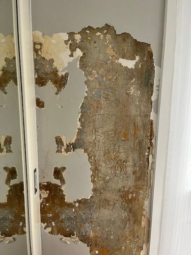

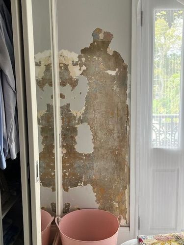

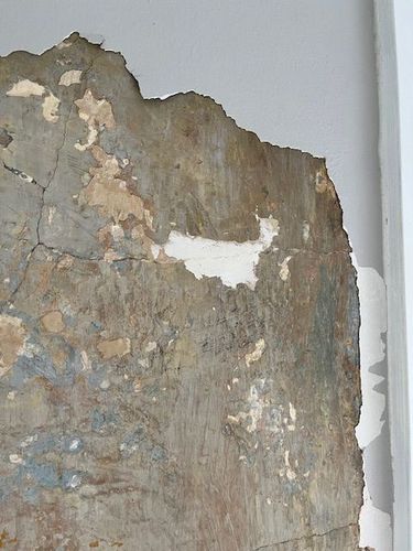

Hi there, after scraping off bubbling paint and plaster and after applying Bondall Silasec Cement Concrete Masonry Waterproofing I intend to then plaster over before painting a relatively small area of wall. I am looking for advice on the best plastering solution to use. Thanks.

Have you scrapped away more of the paint/plaster since the photo? Whichever way forward the flaky parts need to be removed. If you try and smooth the edge then the original issue will return for sure.
Do you have water running down the outside of the building is the next question? I am just wondering what the reason the paint bubbled in the first place. I have a sneaking suspission that the area that you will need to waterproof is larger then the area you have stripped back.
I havnt put plaster direct on a wall before so had a squiz on dr google.
Sounds like two or three stages will be needed. I would suggest to wait for @MitchellMc or @EricL as they will be a lot more knowledgeable.
Thanks, Dave. I have scrapped off what comes off easily enough for now and don't intend to take it too much further. There's no running water down the outside of the building but this corner doesn't get much sun. I've checked and there's no other bubbling - phew! I also now have a ceiling fan for circulation and keep things open on warms days.
So next it will be onto plastering. All new to me and unsure of the best type of product. Thanks, again.
