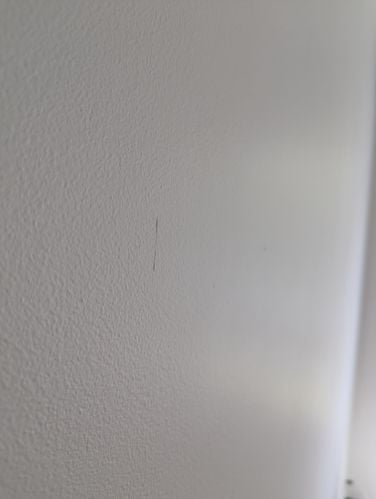

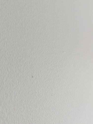

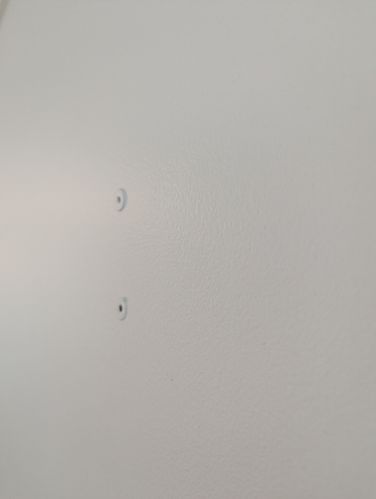

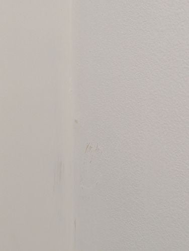

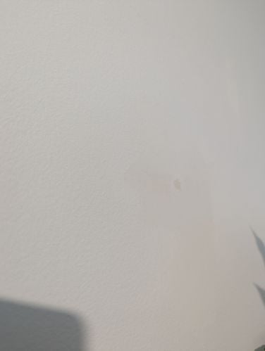

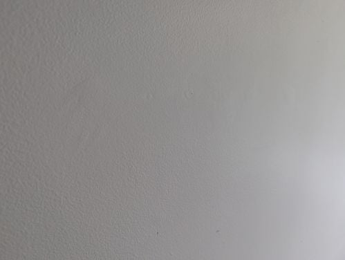

I was hoping for some advice from the wise heads here regarding a cost-effective and efficient way to prep interior plaster walls for painting. The previous owners slapped on one or potentially two coats of paint on top of the previous paint, with minimal prep. You can see this through the paint in the form of way too many lumps, bumps, paintbrush marks, and dirt underneath the paint or present at key eye level.
Based on my research, I've tried skim coating with Gyprock's topping compound, and it's definitely given me the best results in terms of smoothness and workability. However, it's not the most cost-effective when you're trying to cover about 100 square meters of interior space, and it leaves a significant amount of mess to clean up, which the finance minister isn't overly happy about.
A friend of mine suggested sanding the walls with 180 grit paper first, followed by three coats of sandable acrylic undercoat, a final 240 grit paper sand, and then finishing up with the desired paint. This idea sounds good and easy to manage and clean up while tackling one or two walls prep every second day.
I'd love to hear your thoughts and see some photos for reference. The paint feels like sandpaper with a lot of grittiness. I totally understand that certain chips and holes will need filling and sanding regardless to achieve a smooth finish.
