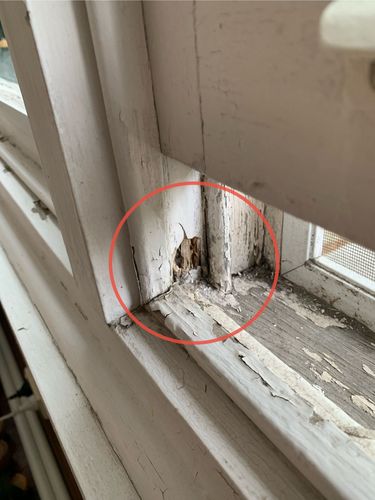

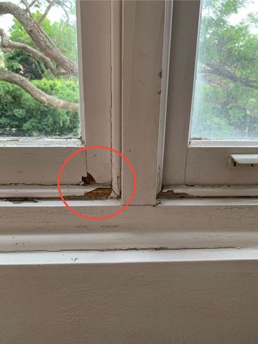

So I tested the wood with a screwdriver as suggested. The corner of the frame is soft but not completely rotten (might be okay with wood hardener), but the inside of the frame crumbles completely when pressed in that corner. I think maybe there is some localised wood rot and it’s only just spreading to the front of the frame.
I can’t find issues with other sections, but I was wondering how this could possibly be resolved without replacing the entire set of window frames. I assume it will keep spreading if the wood is not replaced…
If I do replace the frames, would double glazing be an option? I think it would be great for energy efficiency…
What kind of contractor would I need for a job like that?

Wood rot is a sign that water is getting in somewhere, so if you were to repair and not replace the frames, you would need to track down and seal the source of the water. This can be a bit tricky as water can find its way in through a small gap somewhere around the window and track its way down through the wall, along the window frame and eventually pool at the bottom of the window where it will sit and rot out the timber. If you have a look around the outside of the window frame, can you identify any gaps that could be potential entry points? If so, they would need to be sealed in some way, likely with silicone or a similar filler.
Typically, a timber window is constructed as a whole unit and then is installed into the frame. The rot you've shown in your images is on the stiles and bottom rail of the window unit, meaning you couldn't really remove the individual timbers and replace them without taking the whole window out. You could repair them with a wood hardener and filler or by cutting out a section of the timber and replacing it, but the viability of this all depends on how bad the rot is. If you could gently push on it with your finger and it crumbles, repairing with wood hardener is probably out of the question.
If you wanted to look at a repair involving cutting out a section and replacing it, I'd suggest speaking with a carpenter or glazier with experience with timber window repairs. If you Google "timber window repairs near me", you should be able to find some companies that specialise in this sort of thing.
I imagine you would be able to install double glazing if you decided to remove and replace them, but it would be best to speak with the professionals to ensure there is a method that would suit. Again, a carpenter or glazier with experience with timber windows would be the way to go.
