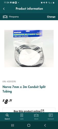

The Narva split tube would probably be a tougher solution to the spiral wrap and better coverage.
