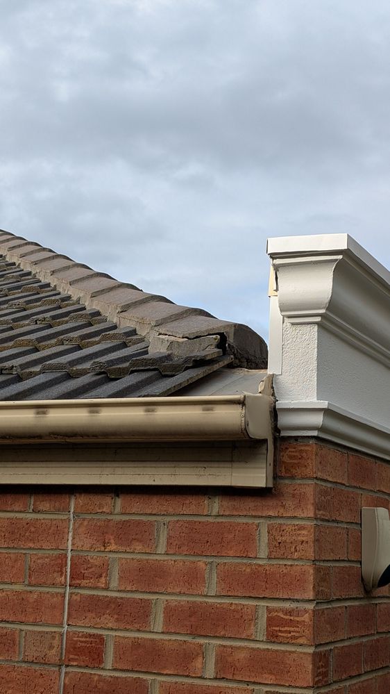

Hello!
I noticed one of our ridge caps needs to be re bedded and repointed, is there still a 2 in 1 product? or is it advised to buy the pointing and bedding seperately?
What do i need to buy to resolve and fix this?
Any assistance would be appreciated, I am new to this.

I recommend using Mortar Mix in combination with Bondall 1L BondCrete Cement Additive to re-bed the ridge cap. You'll need to purchase the tile pointing as a separate item for your repairs.

If you decide not to use the Bondall 1L BondCrete Cement Additive, it's important that the surface be very clean and that the old mortar be totally removed. Please note for better mortar adhesion make sure that the surface is rough. I Propose using a steel brush to rough up the surface of the roof tile. The main purpose of the Bondall cement additive is to give extra adhesion to the mortar base.

Mortar is a mixture (typically cement, sand, and water) used as a structural bonding agent. On a tiled roof, it's primarily used to bed ridge caps, gable ends, and sometimes hip tiles, securing them in place over the main roof tiles. Its role is to hold things together structurally and bear loads.
Pointing, on the other hand, is the finishing layer that goes over the visible edges of that mortar. Traditionally, it served to seal the joints, protect the underlying mortar from weather damage, and give a neat appearance. In older roofs, the pointing was often just a cosmetic skim coat of mortar over the bedding. However, modern roofing often uses flexible pointing compounds, which are more resistant to cracking and movement caused by thermal expansion or structural shifting.
While yes, you technically can use mortar as pointing, it’s not ideal anymore. Mortar is rigid and can crack over time, particularly in Australia’s fluctuating weather conditions. Once cracks form, water can get in, leading to leaks or even tile displacement. That’s why flexible pointing compounds (usually polymer-based) have become standard practice, they move slightly with the roof and last longer.
So, for repairs: use mortar to bed the tiles if needed, but finish with a proper pointing compound to ensure durability and weather resistance.
