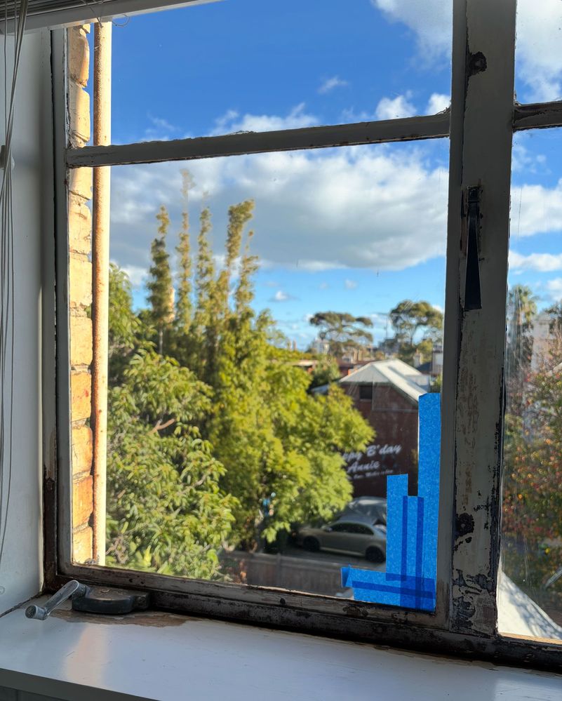

I'm trying to get my steel window frames back into shape – I love the sleek, slim profile but they really are high maintenance to keep rust at bay with the typical condensation that comes with them ... I have a few issues that I would love some advice on.

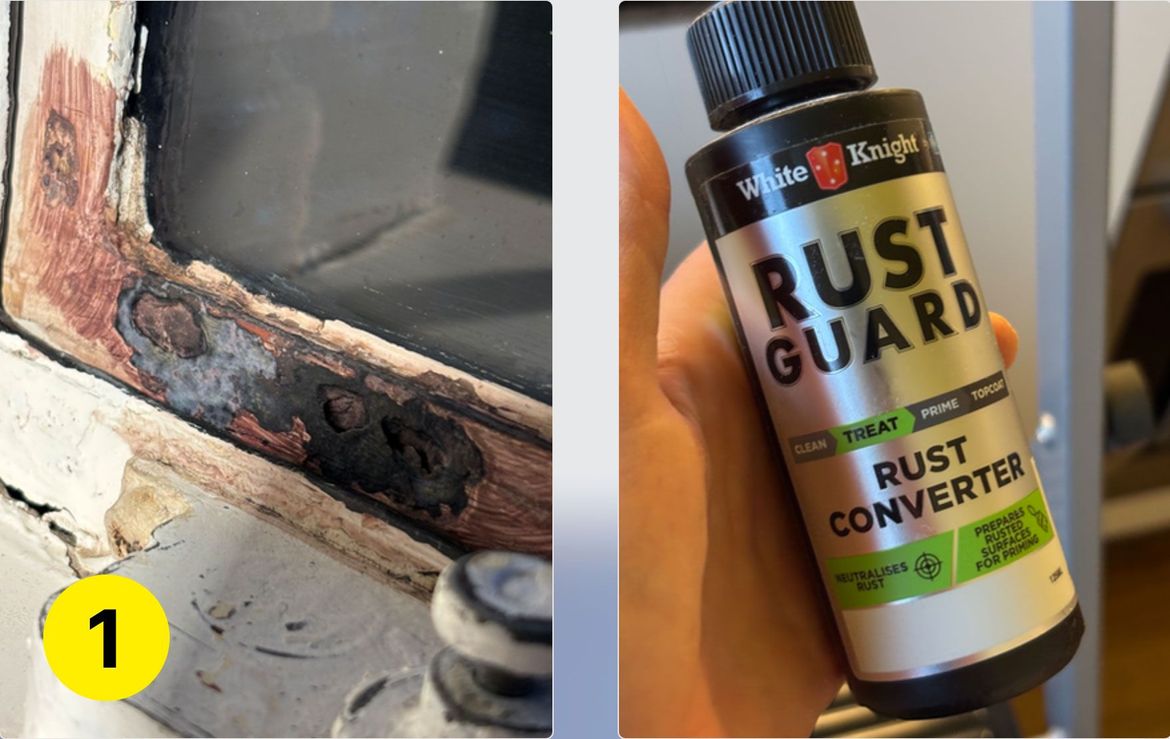

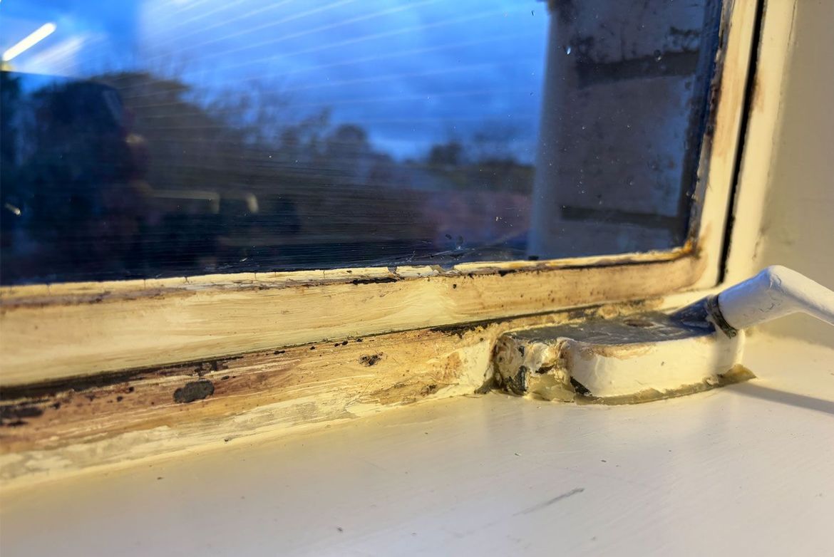

1. 'Rust blisters' creating holes in steel frame
I started with sanding the rusty bits on the frame and found one bit that appears to be hollowed out ... I have sanded it as much as possible and treated with rust converter – however, I'm unsure how much more should I take off – without compromising the frame. I also assume I should fill the holes with something? See photo 1

My understanding is that I need to sand over the applied rust converter to make the new enamel paint stick. Do I need a primer or will the rust converter treatment and sanding suffice?

In case you're wondering, yes, I will need to replace the window sills, they rotted from underneath and the sides – but this is a problem for another day.

Any rust that flakes off or can be chipped away isn’t offering any structural support, so don’t hesitate to fully remove it with a wire brush, scraper, or sander. You’re doing the right thing treating it with a rust converter. Once dry, fill any holes or deep pitting using a two-part epoxy putty—this gives you a strong, sandable fill. Make sure you don’t overfill, as sanding hardened putty down can be quite the task.
Paint strippers can be very effective, but they may soften adjacent silicone seals. If this happens, you’ll likely need to re-seal those edges once you’ve finished painting. Using silicone after the paint job won’t trap moisture as long as the metal was properly prepped, treated and sealed beforehand—this is the key to avoiding corrosion under the surface.
You’ll definitely want to sand over the rust converter to smooth the surface and help the primer stick. A metal primer is strongly recommended—even if you've used rust converter—as it ensures adhesion and adds a further layer of protection. From there, a couple of coats of water-based enamel will give you a durable, easy-to-clean finish.
