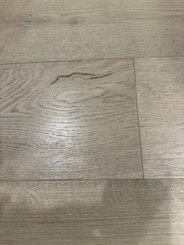

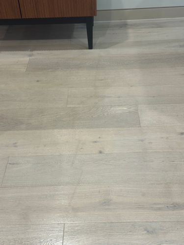

I have attached a pic and I think they are water marks under the floorboards coming from the external apartment wall. There has been water damage about 5 years ago  and this is the replacement floor laid down 2 years ago.
I tried explaining to strata about weep holes at that time  but as they said “ if it ain’t broke …. You know what I mean. Can the boards be replaced after wall problem is fixed. It’s tongue and groove I think .

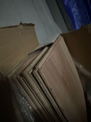

I have attached an image of the invoice when it was first supplied and the spare box of planks. It was supposed to be timber ? What do you think it is as it was insurance claim and if they laid vinyl then that is fraudulent behavior

Hi @zorba,
Apologies, your floorboards appear to be timber, as evidenced by the splinters on the spares. The reflecting light on the original photos made them look much more like laminate floorboards.
With this being said, you will be fine to use the cloudy ammonia to remove the polish. Just follow the instructions on the label for mixing and application.
When you say there is an issue with water entering the apartment, has this been fixed?
If not, then it should be the priority before replacing any floorboards.
Once you are sure it is managed, then you should be able to replace the damaged floorboards by working your way back towards them from the nearest wall. As they are tongue-in-groove, it is not simple to remove and replace one in the centre of the room. A professional floor layer may have a technique that they can use, but I am not aware of one that would work.
