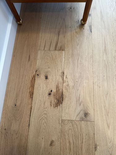

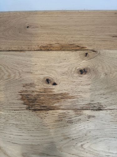

Hello, We have a dark water stain in our wood floor from indoor plant pot. I have tried to clean it wit a little bit of bleach still no luck. Much appreciate if you can suggest a suitable product that might help to get rid of the stain, thanks.

I suggest starting with the basics and that is with a toothbrush some water and detergent. Scrub along the dark spots in the direction of the timber grain. It's possible that mould and mildew have settled into the grain of the timber floor. Once you have scrubbed it as best you can, I suggest using a hair dryer to dry the floor off.
If the blackness refuses to go my next suggestion is using Exit Mould 500mL Mould & Stain Cleaner Trigger Spray. Please note that this is a very powerful mould cleaner and excessive use could bleach your timber floor excessively and damage could occur. I suggest using only one drop of the exit mould on the darkest parts of your floor.
Scrub the surface with the toothbrush and once clean dilute the surface with water and dry it off with a clean rag.

Hi @happycat @and@EricL I have used Exit and able to get rid of most of the dark stains. I sprayed Exit into the effected areas and left it for 5-10 minutes, then slightly scrubbed and wiped it with a damped cloth. I was happy with the results. Good luck and hope it works for you.
