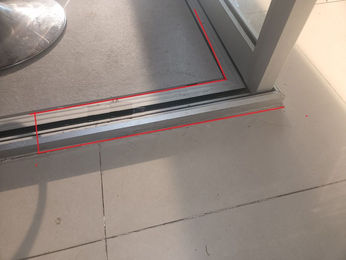

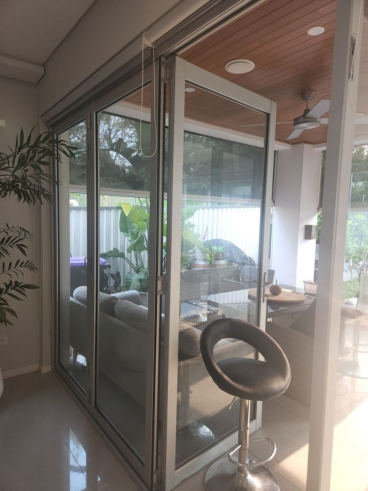

I would to to remove these aluminium bi-folding doors completely. I know how to remove the doors itself but not sure how to remove the bottom frame. I don't see any screws. See images. Thanks.

I suspect the rails have been installed onto the concrete base before the tiles were installed. I'm a bit worried that forcefully removing the rails will result in your floor tiles getting damaged as well as the floor rails probably have a flange under the tiles. I suggest engaging the services of an aluminium door installer to examine the bottom rail and see if it can be uninstalled without damaging your floor tiles.

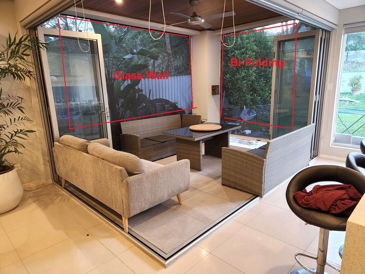

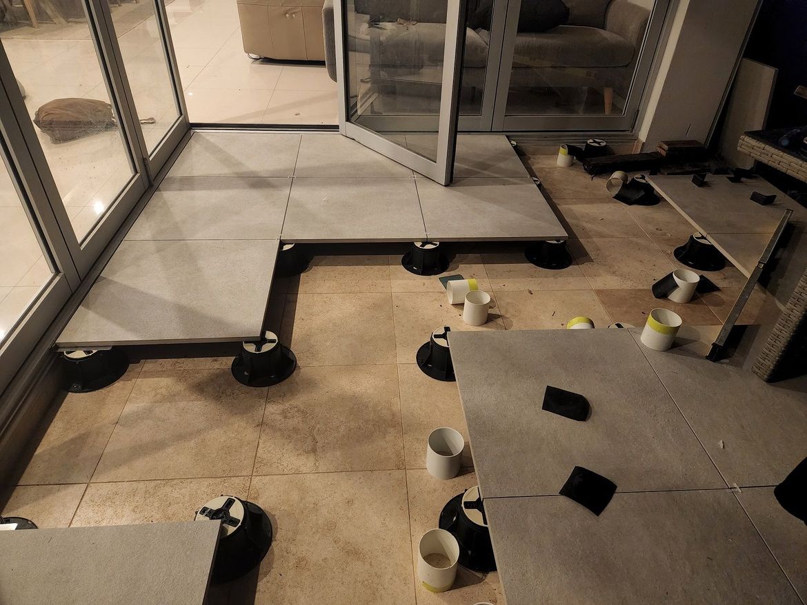

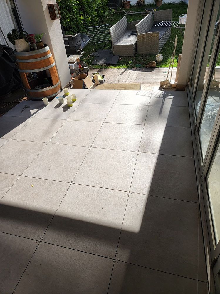

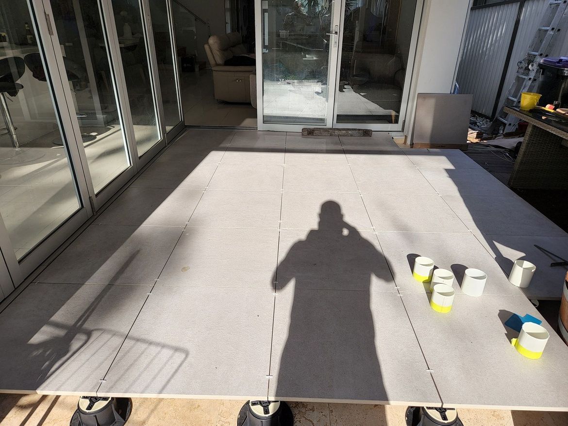

so my plan is to incorporate this alfresco area as part of the house. The first part of the plan is to raise the floor to the same level as the inside of the house. Second part is to remove the two bi-folding doors and rails. Third and final part would be to re-flooring all together so it would look like one big kitchen/dinning area. As part of the "testing" phase to see how it would look, I have temporarily raised the floor with some pedestal and put some tiles I had for the external area just to see how it would look like. Now that I liked, the plan is to do this floor raise with concrete and put some proper indoor tile to match the existing ones.
That is why I don't mind if I break the files close to the door rails/bottom frame. I might remove them anyway and add new ones.
Sending few pictures of how I raised the floor for now and what I am planning on doing with the glass wall and new bi-folding doors.

Hi @Flavio The door frame tracking and bi-fold door system would have gone in at frame stage for the house unless it was a later renovation. The doors will need to be detached from each other, then each door removed. Before permanently fixing the alfresco tiles in place, I would remove them. Then remove the silicone or grout between the tracks and the inside edged half tiles. This will provide a gap to protect those tiles from breakage in the process of removing the tracks. To remove the tracks themselves I would get the advice of installers as @EricL and @Dave-1 suggest. Ideally you want to preserve them as they will have a 2nd hand value if you're not repurposing.
