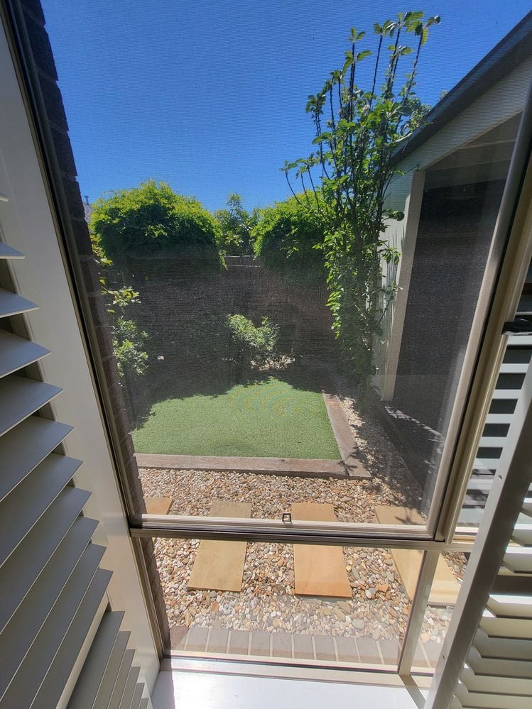

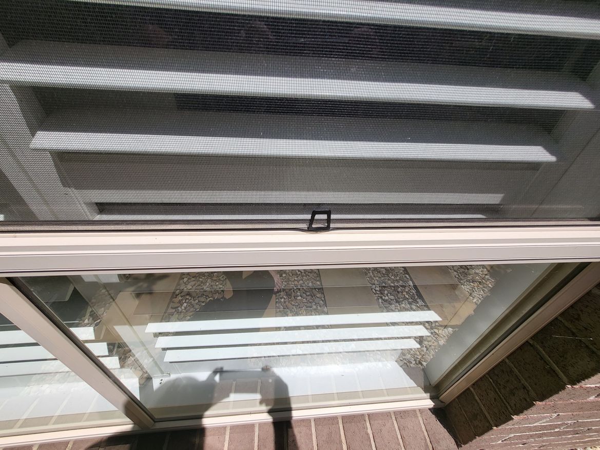

Moved into a new house recently and i will be buggered if i know how to take out the flyscreens. If you can see they have tabs on the outside (which i think is unusual - surely they should be inside) and i have ripped a few off trying to get enough purchase .
The lift straight up and i would have thought with a bit of fiddling would pop out either side, i don't want to bend the fram too much as it looks close to crease point. Any guidance on how to get the remaining ones and ones now without tabs out would be much appreciated.Lifted up....shortly after this tag came out!

Perhaps try pushing the top horizontal length of the frame into the recessed channel instead of trying to pull the bottom up. You'll be able to push it in the corners with quite a bit of force without the worry of crimping the middle down below.
This should be a relatively pain-free task. They slot into the recessed frame, allowing the other side to be easily removed. Since you are having some difficulty with that, I wonder if there is something else obstructing it?
I have similar screens in my place- if the window is open, you can lift them as Mitchell said up into a groove in the top, then slide to one side into a similar groove, then pop the bottom corner out and then lift it down. I have had to use this method when locked out of the house a couple of times! (This admittedly demonstrates that fly screens are not security screens)
