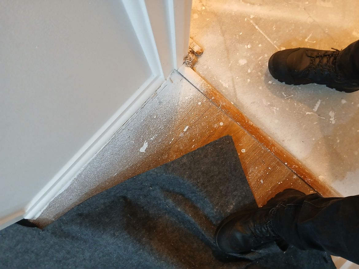

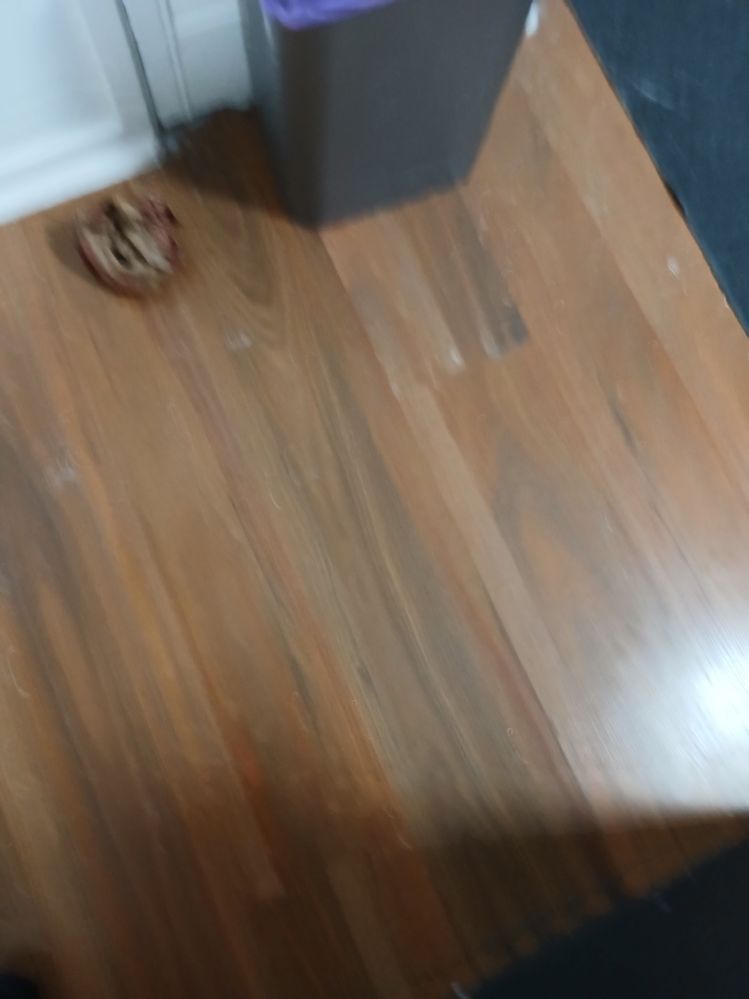

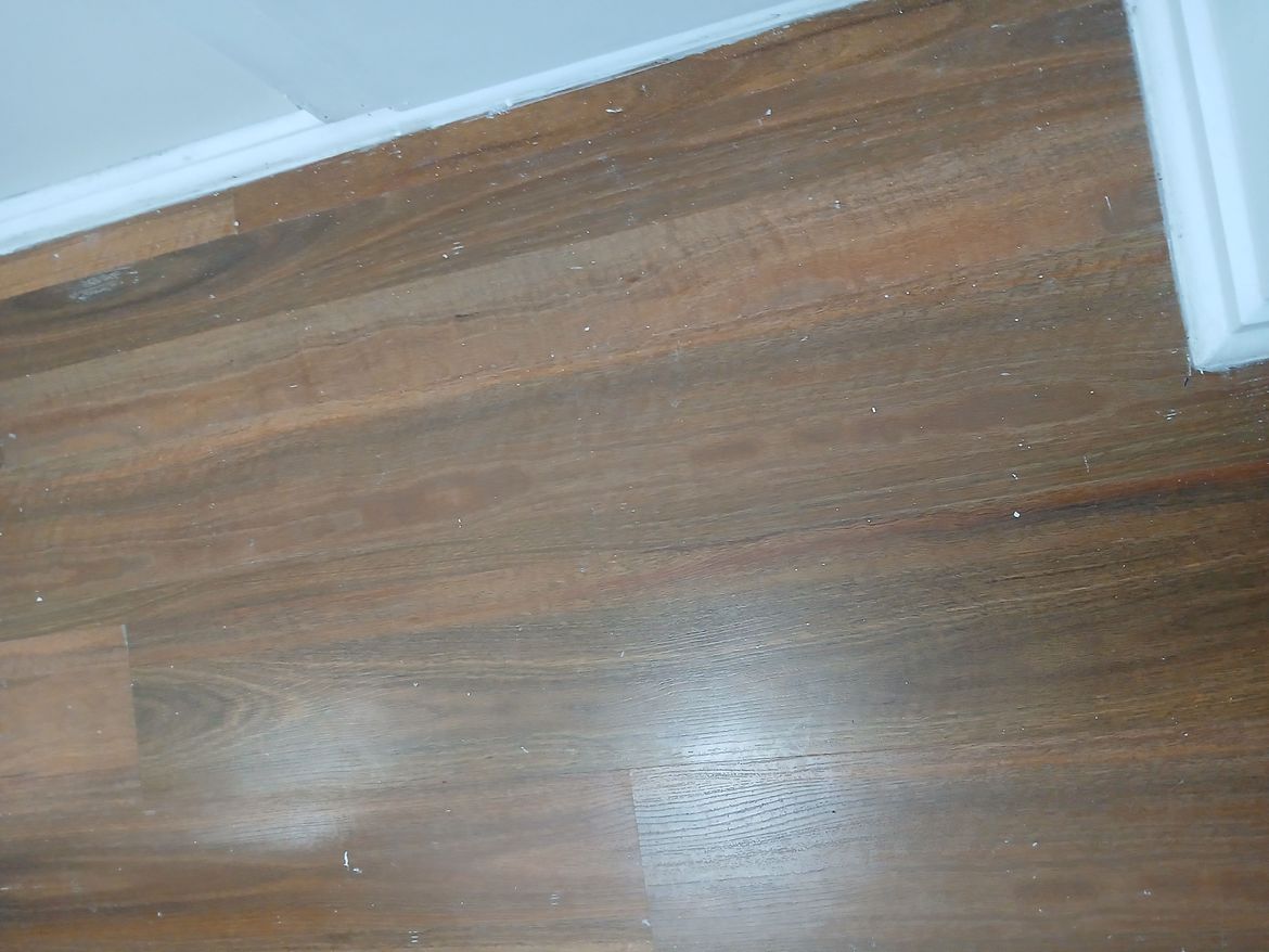

Hi @Finimadness,
You could start by trying some turpentine. Make sure you try it in a test area before committing to its wider use. Apply a small amount to a soft cloth and gently rub the paint spots. Turps is less harsh than other solvents and, if used carefully, is less likely to affect the finish on the floorboards. Just be sure not to leave it sitting too long on the surface, as it can still soften or dull the finish if overexposed.
For thicker or dried-on paint spots, you can carefully use a knife blade held at a shallow angle. Be very cautious with sharp blades to avoid scratching or gouging the timber. A gentle touch and patience go a long way here.
Do you know if they are real timber floorboards, or are they a timber-look material?
If they are timber, then you could consider being more aggressive and using something like acetone or sanding them back, but this would mean you'd have to refinish the floorboards.
If they are a timber look material, such as vinyl or laminate floorboards, then you may need to replace them.
